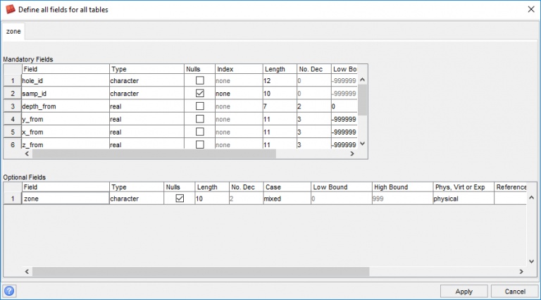

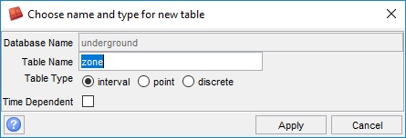

Create an intercept table in the database if this is not done already.
Database > Administration > Create Table

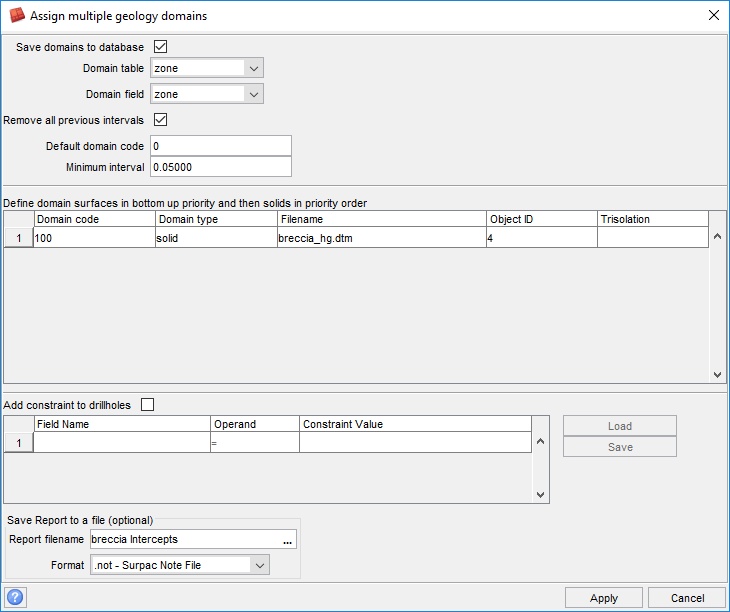

Step 2
A zone code now needs to be assigned to the database for the solid/dtm you want to composite.
Database > Analysis > Assign Multiple Domains.
In this scenario we used a default code of 0 for all the drill hole intercepts outside of the solid, and 100 for the drill hole intercepts inside the solid.

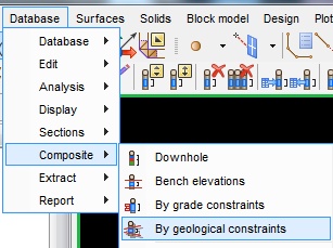

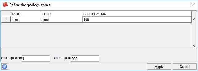

Step 3

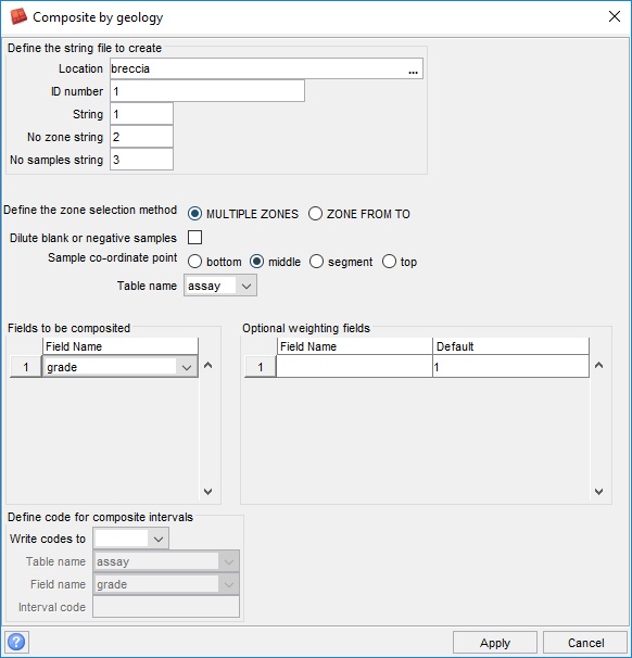

The database now needs to be composited using zone=100 as a constraint.
Database > Composite > by Geological Constraints
Step 4

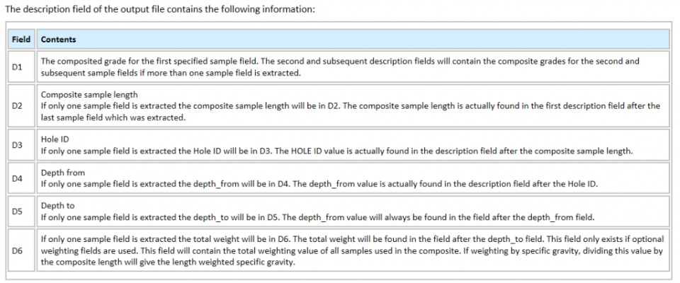

A string file will be produced with the following information in the Dfields. D1 has the composite assay field that we require.

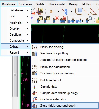

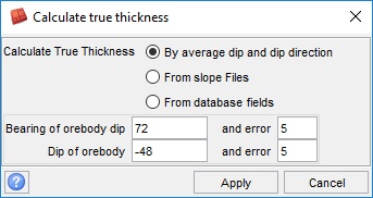

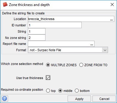

We now need to calculate the true width of the interval previously composited.
Database > extract > zone thickness and depth.
Tick the box for ‘use true thickness’, and enter in the dip and dip direction of the ore body.
Step 7

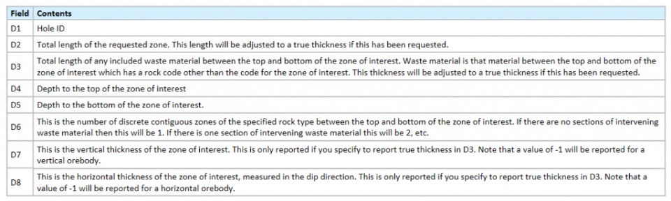

A string file will be produced with the following information in the Dfields. D2 contains the true thickness.
Step 8
Open up the resultant string file and again delete the string that is at the collar (usually string 2) and save

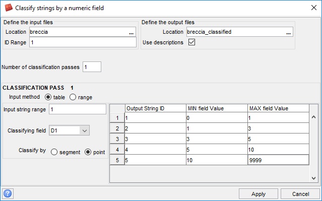

Step 9

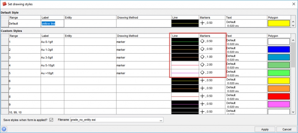

The data now needs to be broken up into grade bins.
File tools > Classify strings by number
Step 10
Open up the resultant string file and adjust the styles.
Customise > display properties > strings and points
Customise the color, the marker type and size. Remember to save the styles file, then save the string file, so the styles file is hard coded with the styles file you have just created.

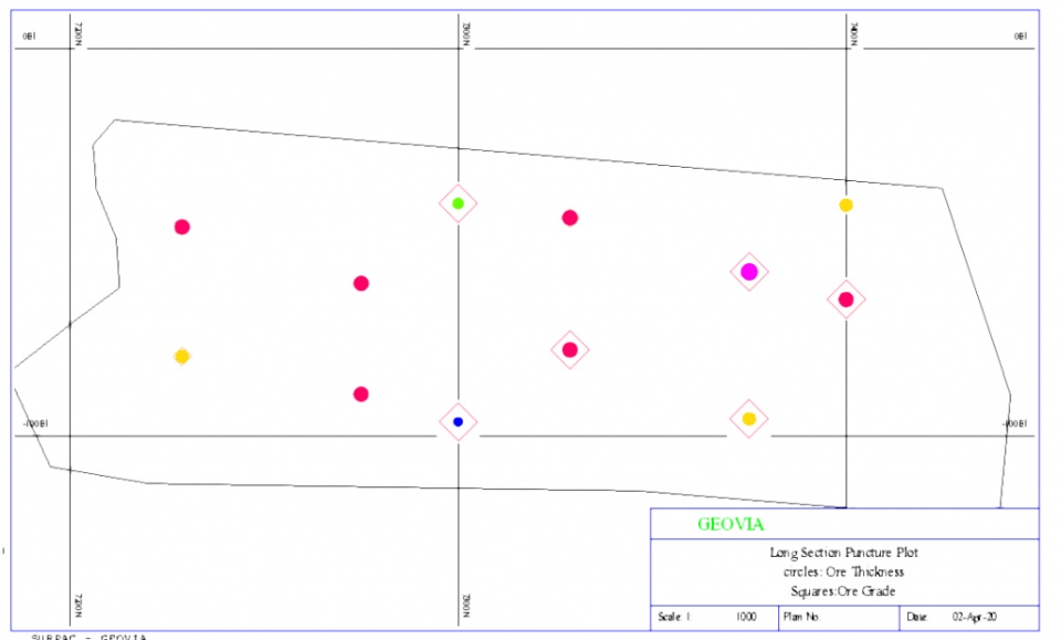

Creating a Simple Long Section Puncture Plot
Step 12
Depending on the strike of the ore body, you may just be able to do a simple long section, or you may need to cut an oblique section (quick planes), or cut an inclined plane (planes > inclined > planes through 3 points) through the ore.
For this example, we will just do a simple long section.
Step 13

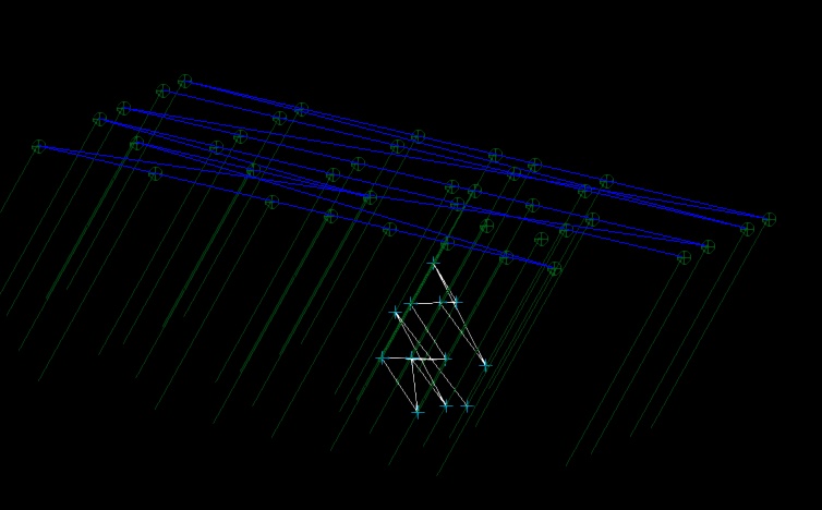

Digitize a boundary string around the edge of the ore body
Step 14
Open up the boundary string, sample data and any design files you require. For this exercise we will just use the boundary and the puncture points.
Step 15
Click on the Y-Z view and display in Long Section and Plot.
