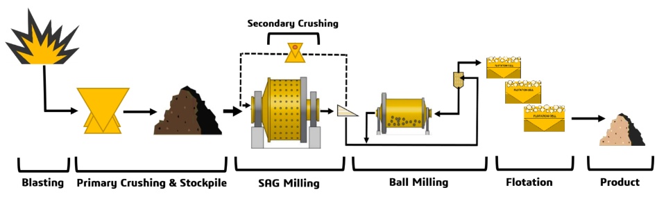

Before implementing the mine-to-mill approach, operations must understand the impact of applied changes on the process and how it may influence interaction between different units of process, including crushing, coarse grinding, fine grinding, and flotation. It is important to note that removing a bottleneck without respecting the next stage operational constraints may result in building a new bottleneck, which would effectively nullify upstream optimization practices. In this article, we consider a SABC circuit (SAG-Ball Mill-Secondary Crusher) to briefly explain how a mismatch between different units may become problematic.
At the SAG milling stage, one of the main operational challenges imposed by feed size and competence variability is the challenge of maintaining a steady load due to changes in SAG mill comminution characteristics and discharge rate. In SABC circuits (depending on operational constraints of a process plant), changes associated with feed size and its properties may induce imbalance of installed power between the SAG and ball milling units. The imbalance can result in the circuit shifting from SAG to ball mill limitation – increasing the risk of underutilization of available power and hence throughput limit.
Coarser and harder particles tend to accumulate and dominate the mill content, limiting the throughput, while softer and smaller particles (smaller than the SAG screen size) empty the mill quickly, increasing risk of liner damage by the steel media.
For a competent ore domain, intense blasting can help generate a finer feed, offsetting difficulty in grinding a harder ore type at the SAG milling stage – resulting in a slightly a coarser ‘transfer size’ (or coarser SAG mill product) being transferred to the ball milling stage at an increased rate – which can limit capacity at the ball milling stage. For a soft ore type, a feed with a high proportion of soft particles in SABC grinding circuits can also limit throughput at the ball milling stage. Because in both cases, an increased discharge rate at the SAG milling stage (often followed by a relatively coarser product) may overload ball mills/ hydrocylone circuit, resulting in increased pressure on recirculating load (~>300%), which often restricts the capacity or “hydrocylones overflow rate”. Another barely discussed scenario might be when crushed SAG pebbles (which are generally comprised of harder material) are diverted to the ball milling stage with the aim of improving SAG mill throughput. As a result, ball mills will process material which may be significantly harder than the “initial” circuit feed. In all these scenarios, the ball milling stage may become "the next" operational bottleneck within the value chain. Therefore, not being able to harmonize the interaction between SAG and ball milling units after applying changes in the feed size or in response to change of ore properties, can result in not taking advantage of finer fragmentation from optimized blasting  practices.
There are various operational strategies operations may adopt to mitigate the risk of shifting bottleneck from SAG mill to ball mills. One such lever is to increase hydrocyclone cut-size (overflow P80) to reduce circulating load – however, this must be coupled with a review of possible negative impact on flotation as the coarser P80 might have a negative impact on recovery. It is worth noting that in many cases, it is required to apply several strategies in addition to enlarging P80, which might include changing the pebble port size, SAG discharge screen aperture (transfer size), etc.

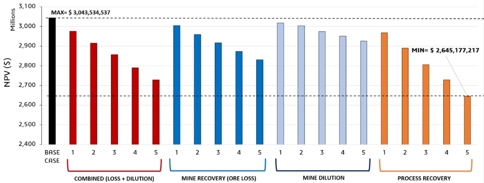

Ore dilution occurs when waste/ lower-value material is sent to the process plant – diluting ROM head grade leading to both decreased metal yield (recovery) and increased cost of grinding. Ore loss occurs when valuable mineral is sent to the waste dump, decreasing ore-reserve utilization and causing significant loss of value over life-of-mine. The graph below illustrates how ore dilution and ore loss could potentially diminish or improve NPV of a copper mine.
As it is shown in the graph, the metal yield and recovery has a significant influence on NPV. The results suggest the importance of establishing grade control strategies at upstream and downstream stages and quantifying value at specific time periods to evaluate their effectiveness. A sustainable grade control strategy requires well-developed pre-blast and post-blast strategies, including measurement, modelling, optimization, and value quantification.
