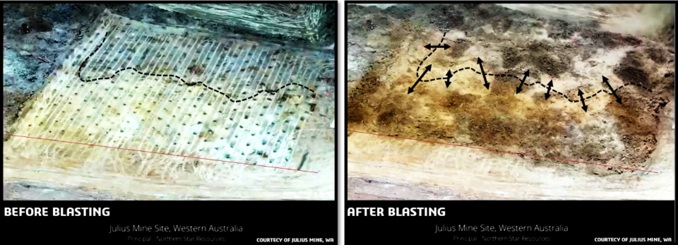

The challenge of ore loss and dilution induced by blasting
Rock mass displacement caused by blasting alters the coordinates of grade boundaries, resulting in ore loss and ore dilution.
Ore loss occurs when valuable material is misclassified as waste and sent to the waste dumps, diminishing the value of the mine over its lifespan. Ore dilution occurs when waste material is misdirected to the processing plant, where it degrades feed quality, lessens recovery, and wastes comminution energy by causing the process plant to grind uneconomical fractions of feed ores.

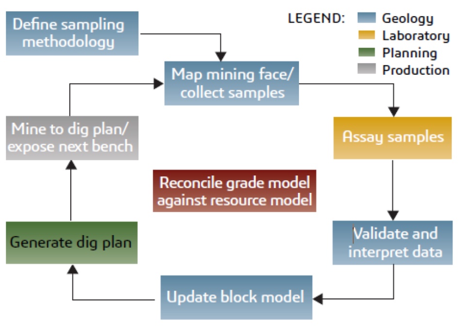

Key requirements for minimizing risk of blast-induced ore loss and dilution
Ensuring that the processes that define grade control are efficient and repeatable is critical to driving profitability.
Grade-control capabilities are an integral part of GEOVIA’s Surpac™, which means we can help you implement new and improved grade control procedures at any stage in the lifecycle of a mine, and develop strategies for dealing with ore loss and dilution induced by blasting.
In the blasting realm, a sustainable grade-control strategy requires well-developed pre-blast and post-blast strategies, including measurement, modelling, optimisation, and value quantification.

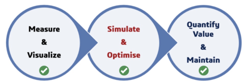

Strategic assessment and control of ore loss, dilution and recovery is an engineering solution specifically developed for continuous improvement and long-term gains. The solution includes three key stages of mapping data and 3D visualisation through block- and grade-control models, mass simulation and optimisation, and strategic value quantification.
Stage 1: Measure & Visualise

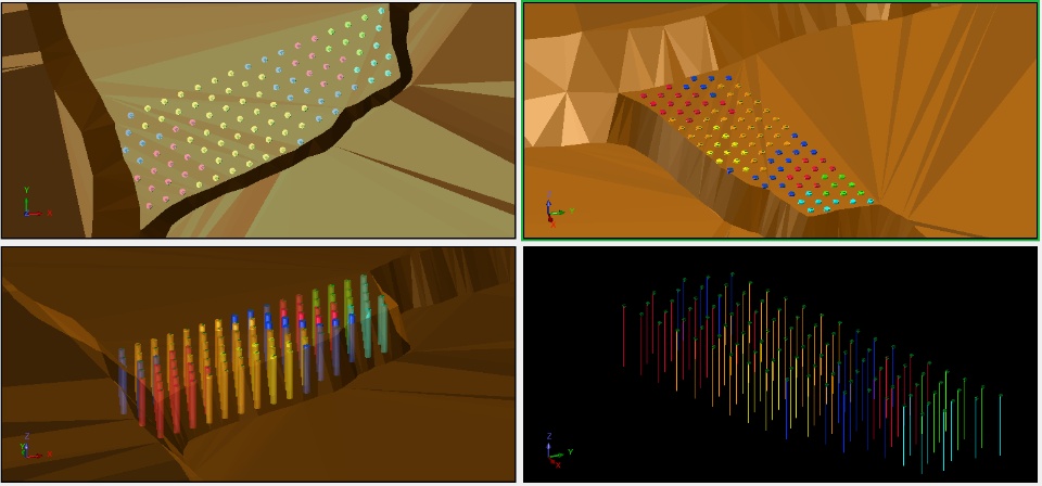

Stage 1 deals with resource modelling and field measurements – i.e. blasthole assays, bench-scale grade control model, material classification, Measure While Drilling (MWD) and Blast Movement Monitor (BMM) data, as well as blast-design parameters.
Any type of data collected can be integrated and used for 3D visualisation, design improvement, and analysis. The input data can express drilling penetration rate, grade, geo-mechanical indices (UCS, Young Modulus, Joint Density, etc.) or geo-metallurgical including grade, mineralogy, ore hardness (BWi), ore competence (SPI or Axb).
  • This allows blast engineers to visualise pre-blast grade boundaries within the block and their post-blast coordinates after movement, and to evaluate heaving performance.
Stage 2: Simulate & Optimise
Stage 2 produces constraint-based scenarios through a massive simulation of combinations of variables in light of grade-control model and field information. Analysis of these scenarios identifies optimal blast-design alternatives for different geological domains while respecting design and operational limits.
  • This stage allows specialists to establish expert-based strategies by comparing pros and cons of best design alternatives in a reasonable timeframe (~1000 scenario per minute).
​​​​​​​Stage 3: Quantify Value & Maintain
Stage 3 is the strategic assessment of potential gains and losses from grade-control strategies adopted in the upstream.
  • This stage allows specialists to quantify the effect of simulated strategies expressed in terms of Net Present Value (NPV).

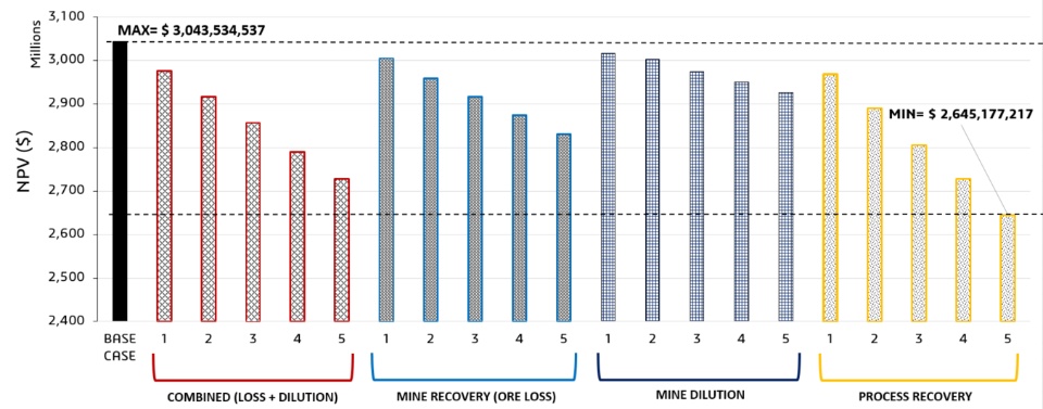

The ‘strategic scenario-based analysis’ below implies how ore dilution and ore loss could potentially diminish or improve NPV of a copper mine.
As it is shown, the metal yield and recovery significantly impacts NPV. The result highlights the importance of being able to evaluate the impact of grade control strategies at upstream and downstream stages at a strategic level and monitor their impact on the overall value over LOM.

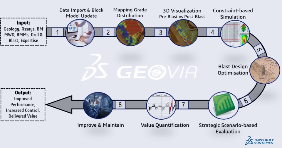

The solution developed at Dassault Systèmes uses globally-trusted, multi-functional software packages that are also capable of dealing with blast-induced ore loss/dilution problems. The workflow below illustrates key steps critical for mitigating risks associated with poor blasting – i.e. ore loss/dilution.
The step-by-step workflow summarises the solution and details how such technologies help address ore loss and dilution problems pragmatically for sustainable gains.
