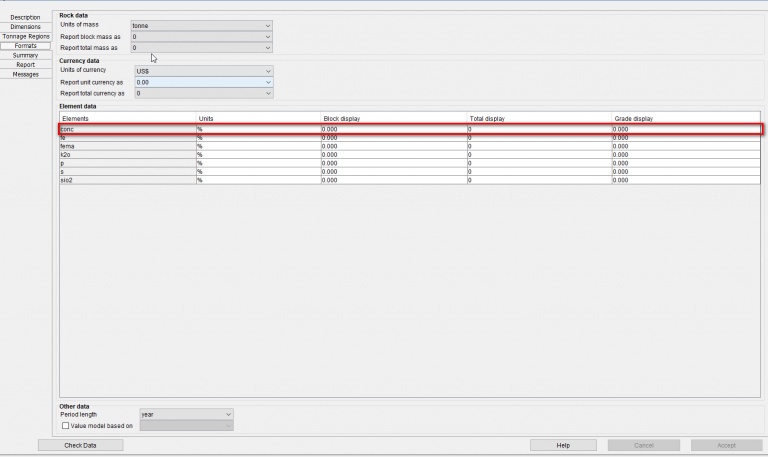

An attribute, in this example, a variable “conc” should be created in your General Mine Planning software (eg GEOVIA Surpac etc.), where the Mass Recovery (MR) – percentage values for the mass of concentrate will be stored in each block of ore generated. These equations are inherent to each process and may have constant values, depending on the approach that one wishes to take (Scoping Study, Preliminary Economic Assessment, etc.).
To export to GEOVIA Whittle this variable should be considered as a variable quality in the block (%), and thus defined in the software.

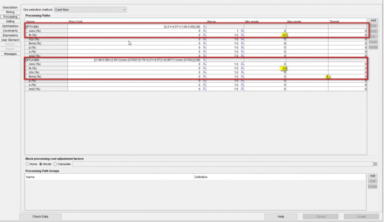

In the New Pit Shells node, Processing tab, the cost equations should represent the process (s) for the production of concentrate to be obtained in each block, allowing the product valuation, and the plant feed specifications must be entered in the Min Grade, Max Grade, and Tresh fields.

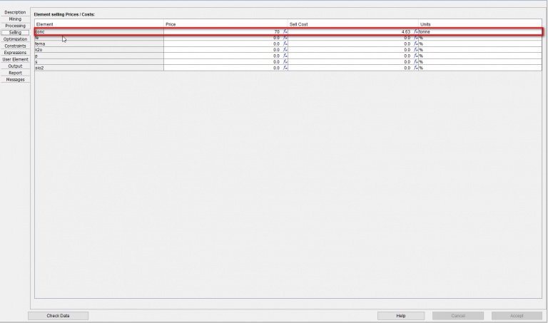

In the New Pit Shells node, Selling tab assign price \\\$ / t conc and change unit to tonnes, thus we guarantee the optimization of the pits according to the value of the concentrate to be produced and we obtain the family of nested pits for the continuity of the studies of the definition of Final pit and strategic long-term planning scenarios.
