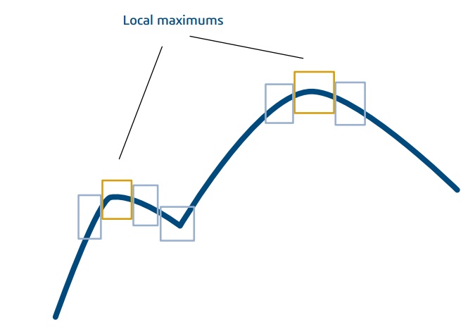

The iterative approach described previously does not guarantee that the solution found is the optimal solution. Figure 5 illustrates the concept in which starting from different initial feasible schedules can lead to different local maximums, and that approach could return a local maximum instead of the optimal solution.
Figure 5 Global maximum vs local maximums

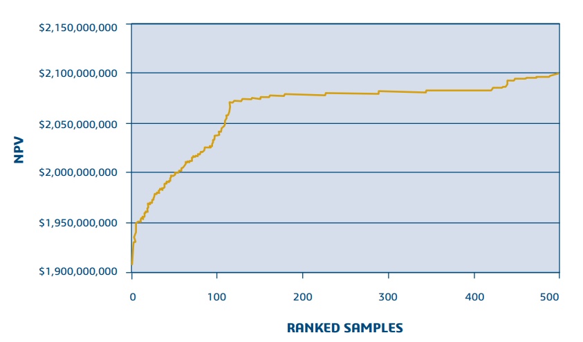

Using a method analogous to Monte-Carlo method, the procedure is repeated a large number of times starting from different initial feasible solutions. Like a mountain climber reaching the summit of one peak, only to find that they were surrounded by other higher points of the mountain, this method places many mountain climbers randomly through the range and the final solution is obtained from the climber who summits at the highest peak. Care has been taken to ensure that the full solution space is randomly sampled so that all local maximums are found. The iterations could be left to run for a long time, however the rate at which a better maximum is found decreases quickly, and the algorithm is stopped when the chance of finding a significantly better solution becomes largely improbable. (See Figure 6.)
Figure 6 Maximum NPV as a function of iteration number
