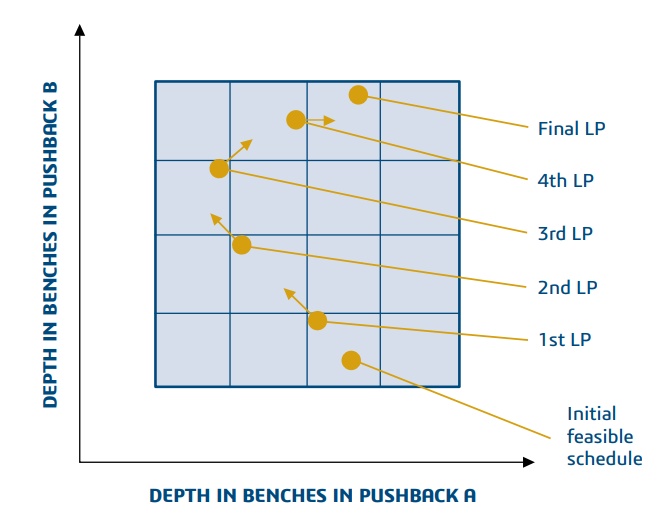

A schedule can be expressed by a vector Xi,j which specifies the total depth mined for pushback i and period j, so that for every period of a schedule, one can know how much of each pushback is mined. For instance, in a simple case of a pit with one pushback, six benches, and three periods, the vector X = (0.5, 3.2, 5.8) indicates that at end of period 1, half of the first bench (bench 0) is mined; at end of period 2 mining reached 20% of the 4th bench (bench 3); and end of Period 3 only 20% of the last bench is left. If the schedule problem is expressed using the above principle while adding mining, blending and processing constraints, solving for Xi,j will provide the optimal solution for the problem. However, the system cannot be solved as it is. It must be linear to be solvable using traditional LP solvers. If the benches and pushbacks to be mined within each period are fixed, one can make the system linear and find the optimal schedule for this specific case using a LP solver. The LP solver will then be able calculate what is the optimum fraction of the bench to mine. In our previous example, if (0.5, 3.2, 5.8) was an optimum schedule, that solution would have been found when we would fix bench 0 f or period 1, bench 3 f or period 2 and bench 5 for period 3. In other words, by providing the initial value X = (0, 3, 5) the solver will be able to find the optimum solution (0.5, 3.2, 5.8) for that case. Fixing the benches and pushbacks to mine in each period is a serious constraint, and it is not practical nor useful to request that information from the user. Since the user does not know a priori which benches and pushbacks to mine within each period, one would have to iterate through all the combinations of benches and pushbacks that can be mined in all periods to find the optimal solution. In the previous example with one pushback, five benches and three periods, the software would need to iterate through 56 combinations.2 That number will grow exponentially as more pushback, benches and periods are added. With just 10 benches, 10 periods and 5 pushbacks the number of combinations are close to 6.7×10 24.Hence, for a normal problem size, this yields too many combinations to evaluate. To solve this problem, an iterative approach analogous to Newton’s Method (Numerical Recipes. The Art of Scientific Computing, 3rd Edition, 2007) is used to find a local optimal (see Figure 4).
Iteration to find local maximum solution from an initial feasible solution.
As shown in Figure 4, starting from any initial feasible solution (the fixed set of benches and pushbacks to mine for each period), the LP solver calculates the optimal schedule; if the solution is within the bounds of the initial schedule (i.e. it has not reached the limits of benches and pushbacks that were fixed) then the program has found a local maximum; if not, the program restarts the process using this last solution as an initial feasible solution for the next iteration. This process can start from any initial feasible solution, allowing a local maximum to be found in the solution space.
