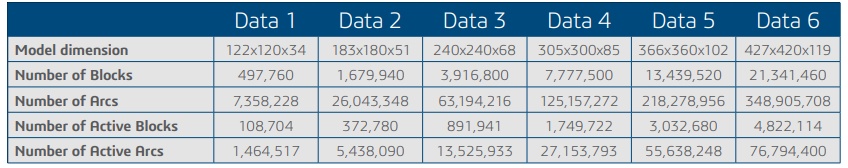

COMPUTATION COMPARISON AND APPLICATION CONCERNS TESTING DATA AND PARAMETERS

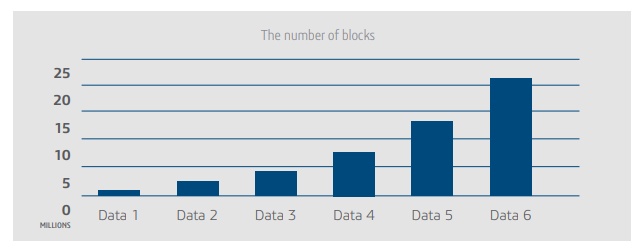

To demonstrate the computation speed of the Whittle pseudoflow engine, a series of testing block models were used (see Table 1 and Figure 6). The 45 degree slope angle is adopted for all cases. The number of arcs created for this slope setting is listed in Table 1. Note that with Whittle, the actual number of blocks and arcs used in the optimization is called active blocks and active arcs. (Active blocks represent the blocks that contain parcels, and all the precedent blocks need to be removed to access the blocks with parcels). Tests were done for two scenarios: one scenario uses one revenue factor (RF) to generate one pit shell; the other uses nine RFs to create nine pit shells. The creation of multiple pit shells is basically a repetition using the pseudoflow/LG across multiple RFs.
Table 1. Testing Data descriptions
Figure 6. The size of testing data

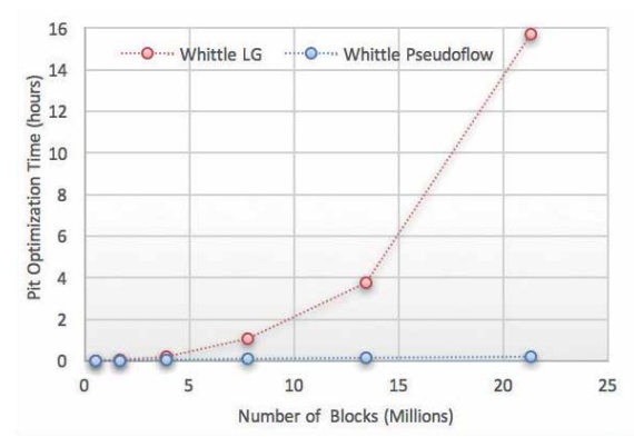

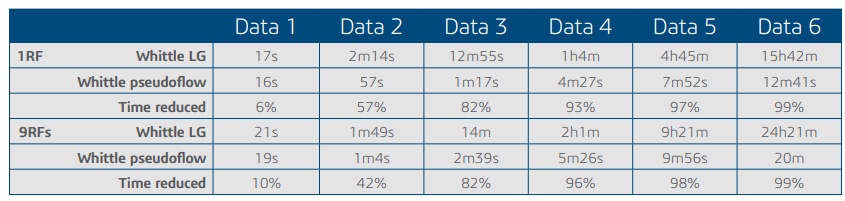

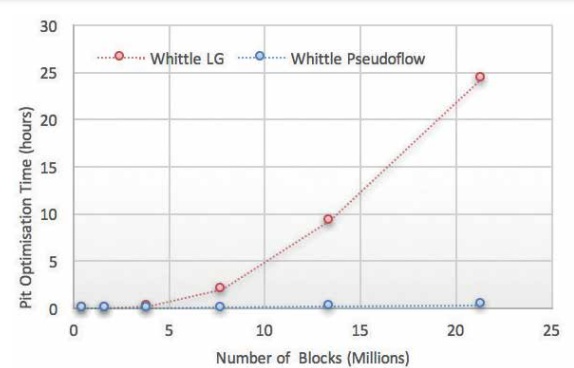

The computation time for the datasets and parameters are plotted in Figures 7 and 8, and listed in Table 2. Note that the collected computation time reflects the overall process of pit optimization with Whittle, including reading and writing data, as well as pseudoflow/LG process. The pseudoflow engine is faster than LG in all cases. The boost of speed is more significant as the block model becomes larger, especially for the 21.3 million block case, with the time reduced from 15 hours to 12 minutes using pseudoflow. Also, when creating nine pit shells, the speed gain from pseudoflow for creating each single pit shell accumulates and shows an even more remarkable overall improvement.
Figure 7. Computation time comparison for one revenue factor
Figure 8. Computation time comparison for 9 revenue factors
Table 2. Computation time of pseudoflow vs. LG
