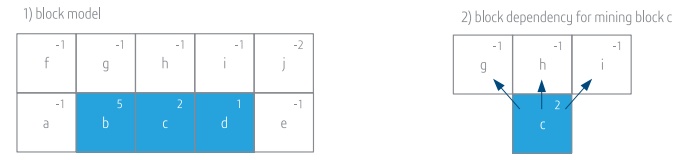

The pit optimization process typically uses a block model with fixed block values as an input. The pit slopes requirement and mining sequence can be expressed by the dependencies among blocks.
For example, in Figure 1-1, a simple 2D block model consists of 10 blocks indexed from “a” to “j” (the value is marked on the top-right corner of a block). To maintain 45 degree slopes, a typical block dependency is like that shown in Figure 1-2, i.e., to mine block “c”, the blocks “g”, “h”, and “i” must be removed first. The optimization problem is to find a set of blocks that respects the block dependency constraints and gives the highest total block value.
Figure 1. An example of block dependency in pit optimization

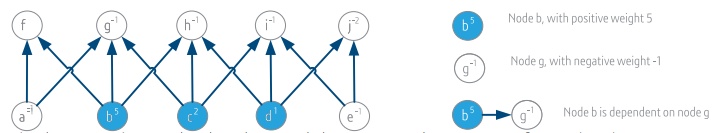

This problem is commonly represented by a mathematical concept called a “graph”. A graph is a conceptual structure consisting of nodes and arcs. In the pit optimization case, a node represents a block, and an arc between two nodes represents the dependency relation of two blocks for the excavation sequence and slope constraint. A node can carry a weight value, to represent the value of the block. Figure 2 shows a graph representation of the pit optimization problem in Figure 1. We will use this example to demonstrate how to use the graph-based method to get the optimal pit. The concept is general and can be extended to more complex cases. Even for creating pits with a large 3D block model, the same process applies, but with an increased dimension and number of nodes and arcs.
Figure 2. A graph representation of pit optimization problem in Figure 1

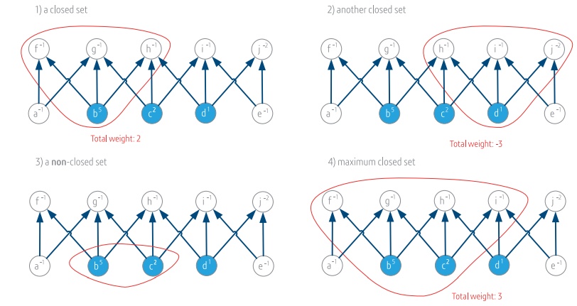

The precise definition of a pit with valid slopes is termed a “closed set” or “closure”. It refers to a set of nodes that have no arcs out of the set. For example, in Figure 3, the set {b, f, g, h} is a closed set and {d, h, i, j} is another closed set; but set {b, c} is not closed, because “b” has available arcs to “f”, “g”, “h”; and “c” has an available arc to “g”, “h”, “i”. A closed set of blocks is free to be removed and does not depend on the removal of other blocks. So, finding an optimal pit is the process of finding a closure with maximum total value.
Figure 3. Closure and maximum closure in a graph
