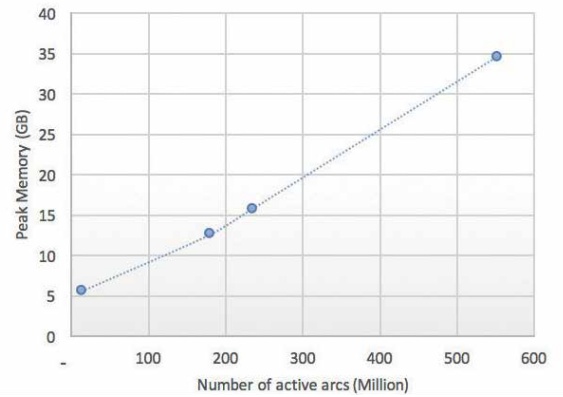

The pseudoflow engine utilizes more physical memory via RAM than LG does. For some large cases, the pseudoflow engine may reach the memory limit of the computer. In general, the memory usage grows almost linearly with the number of active arcs, as shown in Figure 9.
Figure 9 - Memory consumption of pseudoflow engine for the cases of different number of active arcs
The information of active arcs is reported in the pit optimization message tab for both LG and pseudoflow. Table 3 lists typical memory requirements to efficiently solve problems of different sizes (measured by the number of active arcs). Here, the term “efficiently” means “processing without using virtual memory”. Using virtual memory can drastically slow down the optimization and therefore add significant time to the overall optimization process. On the other hand, a slightly larger case can also be solved by using a small amount of virtual memory, with a trade off of speed. For example, with a 32 GB RAM computer, a problem with less than 509 million active arcs can be efficiently solved; and a problem of 550 million active arcs is still solvable by using virtual memory.
Table 3. The pseudoflow process limit (in number of arcs) for computers of different memories
