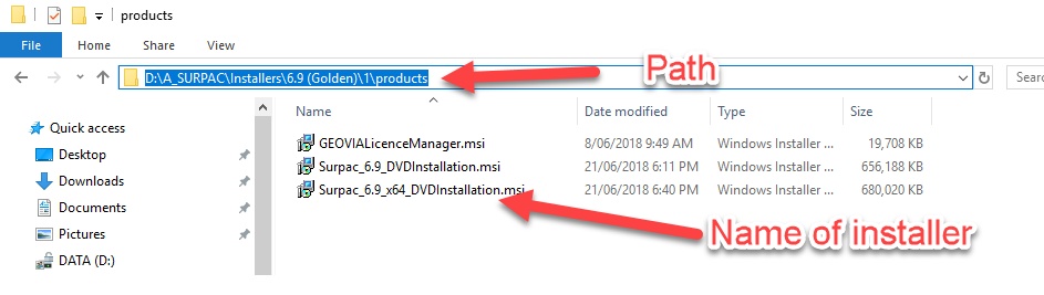

2. Edit the following command: msiexec /i “C:.msi” /L*V “installation_log.txt”
Replace with the directory of the msi installer and with the name of the installer.

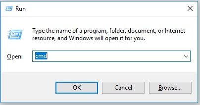

3. Press Windows + R on your keyboard to launch “Run/Search Windows”
4. Type “cmd” and press Enter
