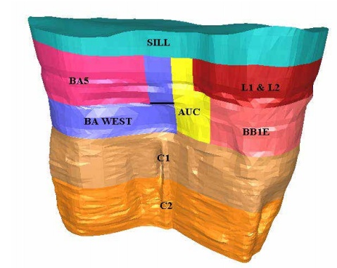

An example of a deposit where multiple lifts have been mined (or planned) is shown in Figure 5 (Diering 2010) for the Cullinan Diamond Mine in South Africa.
Figure 5 Multiple lifts or mining blocks at Cullinan Mine. (Diering 2010)
