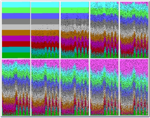

Figure 2 shows output from a 2D Cellular Automaton tool in PCBC representing a vertical cross section for a test case. The left side of each image represents eight closely spaced draw points with regular draw, while the right side represents four points, which are more widely spaced with higher tons being extracted from each draw point. The horizontal (coloured) bands represent different zones or rock. These are preserved more effectively with closer spaced draw points and the incomplete extraction from the right side is clear on the bottom row of images. The upside down “V” shapes to the lower right demonstrate the potential for loss of reserves if the draw point spacing is too large.
Figure 2 Output from 2D Cellular Automaton tool in PCBC for varied draw point spacing.

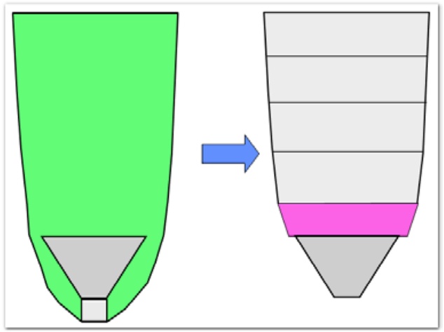

The final adjustment to the ore reserve occurs when detailed adjustments are made around the base of each draw cone to reflect the accurate volumes and tonnages of each draw point (or half draw bell). This usually requires manual calculation of what the true volume will be and then adjusting the computed volumes in PCBC at the base of each cone (Figure 3). Often, the potential reserve tonnages lost at the base of the footprint can be recovered later using pillar retreat or from a second mining lift. For larger lift projects (500m), the tonnage in the bottom 15m is relatively insignificant, but still needs to be accounted for in the overall reserve calculations.
Care should also be exercised to ensure that material from tunnels (on production and undercut levels) is not double counted between production and development tonnages.
Figure 3 Adjusting the base of cone for precise draw bell and undercut volumes.
