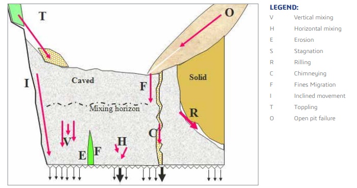

FLOW MECHANISMS
Detailed description of flow mechanisms is beyond the scope of this paper. However, a list (Diering 2007) is as follows:
  • Vertical mixing
  • Horizontal mixing (similar to diffusion)
  • Toppling
  • Rilling
  • Erosion
  • Compaction
  • Major surface movements (eg Pit Failures)
  • Inclined flow along a contact
The various flow mechanisms are shown in Figure 1 (from Diering 2010).
Figure 1 Typical flow mechanisms in a block cave. (Diering 2007)
The understanding and impact of these mechanisms dominates a large part of the dilution and ore reserve calculations in a block cave mine. The three primary ones are likely to be vertical mixing, rilling and erosion mechanisms.

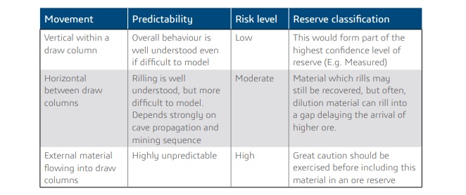

From an ore reserve perspective, and also within the PCBC program, we start by constructing a column of material above each draw point for which properties are derived from the block model. This is referred to as a slice file (as separate and distinct from a block model). As the different mechanisms take place, material may either remain within a draw column or else be transferred to other draw points. This is important from the perspective of ore reserve definition, since confidence in extracting material is strongly related to how much it moves around within a cave. It is reasonable to suppose that material which moves extensively in an uncertain manner would have a lower confidence limit than material, which moves downwards directly into the underlying draw point. There are three cases to consider:
  • Material moves, but remains within the same single draw column. (Vertical mixing and erosion and compaction. Inclined cones can still fall into this category).
  • Material moves from one draw column to another. (Rilling and horizontal mixing)
  • Material moves from outside the defined draw columns into or on top of the draw columns. (Toppling and pit failure).
This is summarized in Table 1.
Table 1 Reserve classification suggestions for different flow types
The above may seem obvious when put into a table, but there are examples where material to the sides of a block cave layout have been included as part of the stated ore reserve but, have not been recovered leading after the fact to ore reserve write downs. This situation is, potentially, quite common since it can occur any time a block cave is initiated beneath an exhausted open pit. The above mechanisms are modelled within the PCBC software. In a typical study, the mechanisms may be turned on or off and the effects on ore / metal recovery studied as part of the overall risk assessment process.
