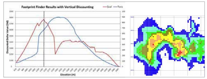

Footprint Finder, a module of GEOVIA PCBC™, was developed primarily to support a quick study of a block model to find the best elevation and orientation for locating an extraction level for block cave mining. Now it supports the creation of a simple production schedule using the sequence as input and offers opportunity to perform several runs in a short period of time to evaluate different options for direction and shape of the cave front for an optimal mine sequence. Some of the characteristic of Footprint Finder include:
  • Compare economic values for different footprints within different areas.
  • Enable quick changing and evaluation of an economic model.
  • Enable a comparison using different amounts of vertical mixing applied to each column using an algorithm based on Laubscher’s mixing method (Laubscher, 1994).
Figure 2: Results from Footprint Finder
  • Enable the construction of block models representing cumulative dollars, cumulative tons and best HOD from different starting blocks and elevations.
  • Enable an initial footprint to be established for flat or inclined extraction levels.
  • Assess multilevel scenarios using maximum height of draw and replacing the material by default values for the upper level.
  • Evaluate simple production schedules using vertical mining

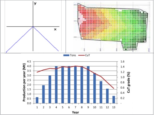

The creation of a production schedule requires a defined sequence based on the shape of the cave front. This is created simply using an X-Y curve and applied with a certain direction (azimuth). An example of a production schedule using a sequence moving east in a V-shape is shown in Figure 3.
The option to create a mine sequence defining a shape and direction provides the opportunity to run many schedules to evaluate different scenarios. The option to start in a specific point and move in a circle to emulate a diamond shape is also available enabling all of the sequence options to be rapidly tested using Footprint Finder.

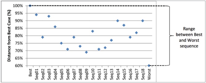

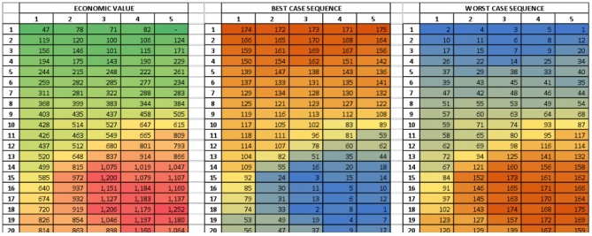

The best and worst case concept can be easily implemented in block cave mines to understand the maximum and minimum NPV, where the cash flow is calculated using a discount rate per year. The order of extraction of each column is very important and has a big impact over the NVP calculated. In this case, the best sequence will be the extraction of the column sorted from the highest to the lowest economic value and the worst sequence will be the opposite. Both cases are non-operational but provide a valid reference for planning purposes defining the maximum and minimum value of any operational sequence. Figure 4 describes an example of the application of this concept showing a plan view of the block model in Microsoft Excel™, where it is possible to see the best and worst sequence, based on the economic value of each block. Figure 5 demonstrates an example of the best and worst sequence concept and how other sequence options are located within this range. The opportunity to identify the value of the best option is an excellent reference for a mine planner when they are comparing different alternatives for a sequence.
If a sequence value is close to the best case, then there is little opportunity to improve the sequence. If the difference between best and worst cases is small, then the overall project itself is not sensitive to sequencing. A simple plot such as the one in Figure 5 is very useful when assessing the effectiveness of various sequences.
