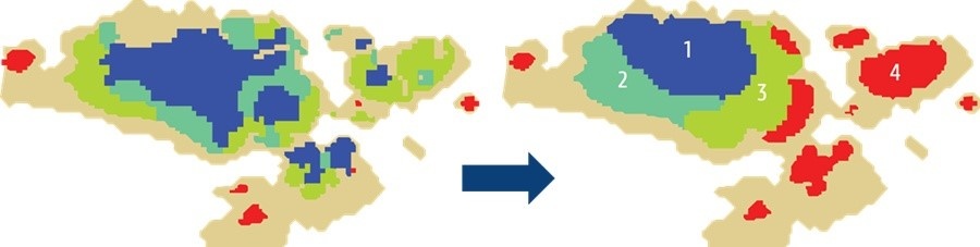

A more flexible approach
Using process-automation tools with mine planning software allows mine planners to better appraise the optimisation solution space, delivering a workflow such as this:
  1. Generate a ‘value map’ based on a modified pit optimisation algorithm that allows the planner to easily:
  • identify the best starting region and corresponding directions, based on an assessment of preliminary strategic schedules for each combination, and
  • compare directional approaches while taking into account other vital components of a mine plan, such as spatial constraints, sinking rate and other feasibility KPIs as well as NPV.
Figure 1. Optimised pit phases.

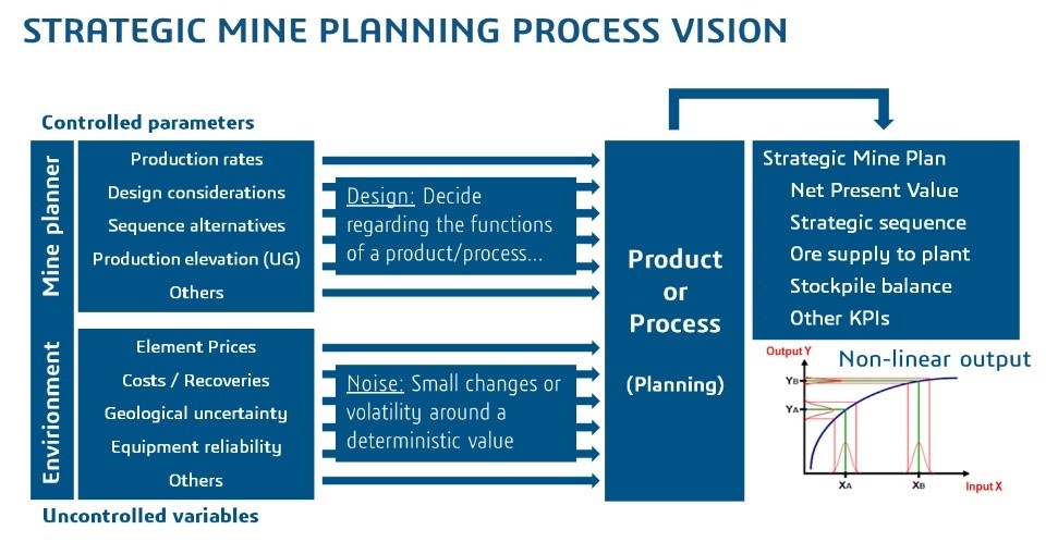

2. Run thousands of possible scenarios based on mining rate and production capacity, their corresponding CAPEX and OPEX (making both the mine and the processing plant, and their corresponding costs, the right size), and cut-off grade, with each scenario producing its own mine plan and production schedule.
3. Optimise the schedule to maximise NPV by identifying what material to mine from each pushback and when, since the “what and when” will affect the mine’s order of revenues and costs (aka cashflow).
For example, the traditional approach has been to optimise the material send to the processing plant based purely on the mining and processing capacity. This can lead to low grade material taking up vital plant capacity in the early periods and reducing NPV among other KPIs.
A better approach would be to stockpile lower grade ore in the early years of production in order to prioritise higher-grade processing early on, and then use the remainder of the viable ore later, increasing NPV over the life of the mine. Even better still would be to not only optimise the processing capacity, cut-off grades, and stockpile usage, but to do this at the same time as choosing the sequence and the pit shells. This would free the optimisation to look at a wider solution space and not lock it in to decisions that were made in the previous step.
Figure 2. Strategic mine planning vision.

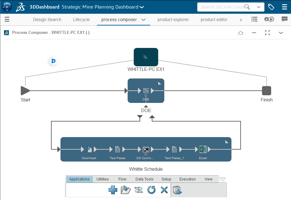

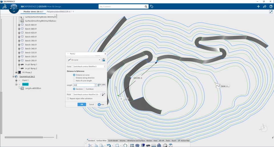

In the illustration below, we used a Design of Experiments (DoE) to perform a wide range of input modifications to a pit optimisation run. This allowed us to calculate tens of thousands of  scenarios and explore the entire solution space, with the output being a dynamic set of pit shells linked to and associated with a set of pit design parameters. This associativity, coupled with parametric design, created the design shown below.
Figure 3. Optimised pit and haul road design.
The design now maintains a constant link with the optimisation results. As alternative scenarios are selected, new designs are automatically created and stored with their own revision and life cycle. We can also choose to link and associate them with other restriction criteria not made available to optimisation, such as pit crusher locations that require their own areas for infrastructure, flat areas in the ramp for regulatory purposes, or sump locations for pumping requirements. And we can assign a template to each of these criteria that is associated with the design and will be used to automatically update it.
Finally, each design can be used again within the life-of-mine scheduling, closing the planning loop and confirming the assumptions taken previously in the optimisation step.
Figure 4. Whittle and Process Composer Design of Experiments.
