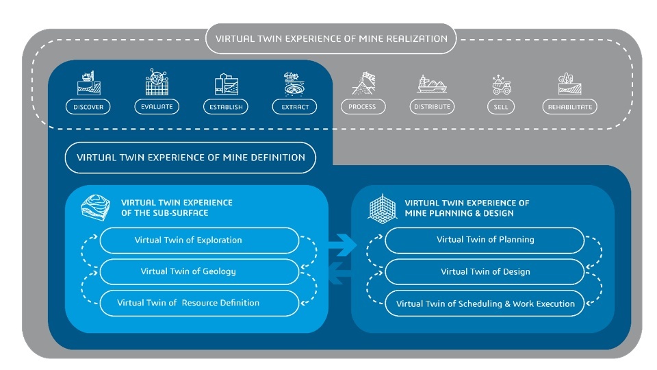

Another potentially more useful way to visualise the mining value chain is as a complex series of interconnected systems. For the chain to work at its best, each system must be able to work easily with, and connect to, the next.
Through virtual twin experiences, you can begin to visualise your systems as a collection of tiered virtual twins, each with its own data sources, processes, and areas of knowledge, like this:
The virtual tiers are linked in a way that enables them to work together to respond to problems that arise along the value chain.

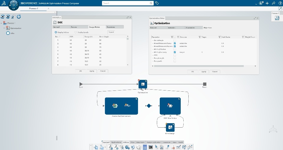

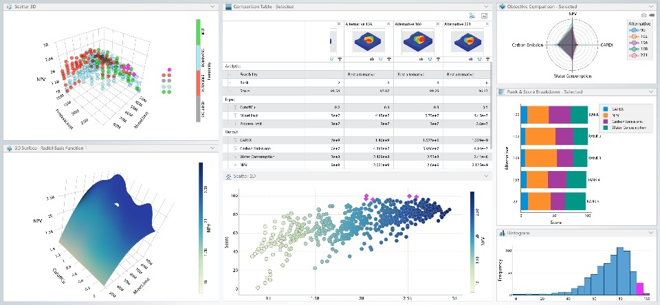

Using generative design and MODSIM together, the team evaluates, within a matter of hours, various planning and design implications through a one-stop planning and design process:
The team first generates 23 pit options analysed from eight different directions, then 1,600 alternatives for the 23 pits based on the NPV obtained for each possible pushback direction plus the target KPIs that most affect their decision making.
  • After whittling down the options to the one with the best pushback dimensions for extracting maximum ore, the team:
    • develops a production plan that considers such factors as mining rate, CAPEX impacts, location of waste facilities and haulage logistics
    • generates 9,680 possible sequences (and the hill of value visual, below) with different cut-off grades, prices, production capabilities, and corresponding CAPEX.
  • From there, each of the possible plans automatically generates its own NPV, with its own hill of value visual, making it easy for the team to see which plan creates the optimal production range.
  • This is good, but the team wants even more precision, so they now use parametric design to identify optimal and practical trade-offs that will ensure their final design plan meets all critical geotechnical and safety rules.
