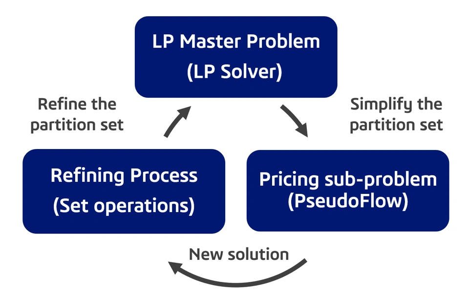

Figure 1. BZ Algorithm summary schema.
Key features and functionality
1. Holistic modelling: Unlike traditional heuristic methods, the BZ algorithm is a global optimisation technique that can holistically model the mining problem. Hence, it often leads to solutions closer to the global optimum.
2. Simplify the problem: The BZ algorithm uses a Lagrangian decomposition technique to break down the original problem into more manageable subproblems to solve the overall problem. This is achieved by dividing the constraint set into precedence and a smaller set of hard constraints. The BZ algorithm groups variables into partitions, simplifying the problem. These partitions are iteratively refined by solving subproblems, including a master LP problem. The goal is to converge to an optimal solution through these iterations.
Step-by-step algorithm
1. Initial formulation: The original problem is formulated as a MILP, identifying all constraints and the objective of maximising extraction value.
2. Problem division: Constraints are divided into precedence constraints (e.g., wall slopes) and hard constraints (e.g., mining capacity).
3. Pseudoflow solution: The precedence constraint subproblem is solved using the Pseudoflow algorithm, which efficiently handles network flows. For each iteration, Pseudoflow costs are updated using penalties that come from the LP Master problem.
4. Partitioning and refinement: Variables are grouped into partitions and solved iteratively. Each iteration adjusts the partitions based on the results from the master LP problem and the Pseudoflow sub-problem, refining the solution.
5. Convergence: The iterative process continues until the LP Master problem and the Pseudoflow sub-problem solutions converge, indicating that an optimal solution has been found.

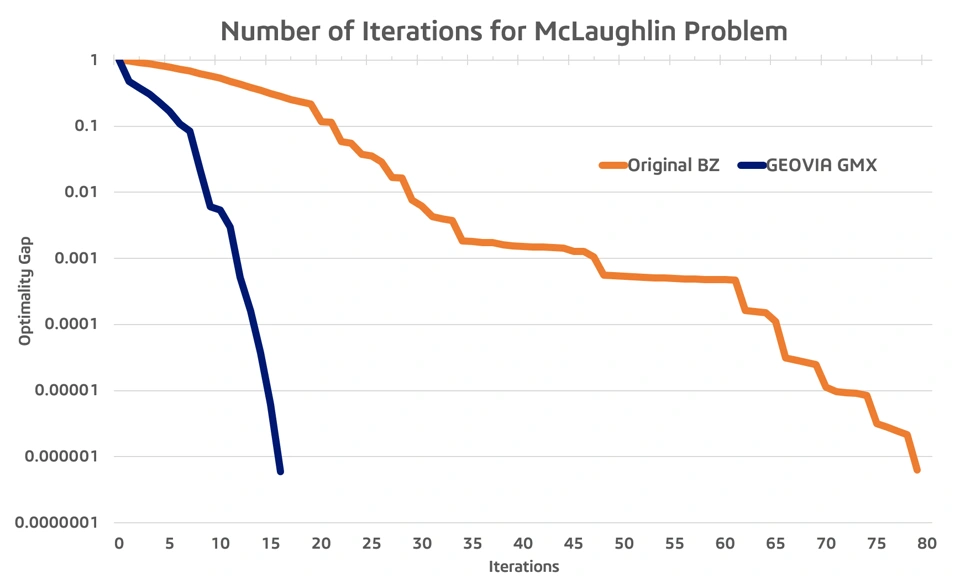

A feature of GMX is its use of a new scheme to reduce the number of BZ iterations significantly. Figure 2 illustrates the effectiveness of this approach by example. For the largest MineLib literature problem, McLaughlin, the number of iterations was 79, using an early implementation of the original BZ algorithm. For the new implementation, this has been reduced to 16 iterations. Of note is the rate of change of the Optimality Gap from one iteration to the next, highlighting the much faster convergence and run times.
Figure 2. Comparison of convergence of the solution for the McLaughlin Problem.

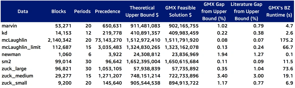

Figure 3 shows the results for the nine benchmark MineLib literature projects. These are Direct Block Scheduling (DBS) problems of various sizes, having processing and/or extraction capacity constraints. All test runs were completed on a standard Lenovo ThinkPad P53 laptop. The BZ algorithm runs until different bounds converge (the BZ Optimality Gap is less than 10 power -6). The last column reports the time to do this work in seconds(s).
Once the LP has been solved, Dassault Systèmes runs ten variants of the literature TopoSort heuristic and the Optimize-Destinations heuristic, to create near-optimal solutions. The combined runtime for these heuristics is fast, taking less than a minute to complete on average. The total maximum runtime to produce a solution is under 5 and a half minutes. Comparing the Optimality Gap (GMX Gap) to the best literature result (Literature Gap), it is clear that best/near best solutions are produced in each case. Lastly, these results compare favourably to those of specialised meta-heuristics, which can take many hours to run.
Figure 3. GMX results for Minelib problems.
