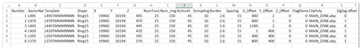

STEP 3: Generate Rings – Determines Ring locations using existing tunnels or using logical tunnels
  1. Setup the xlsx and update the sector input sheet.
2. Create and save clipping polygon for levels on layout ( Edit -> Clip -> Create Clipping Boundary; Edit -> Clip -> Save Clipping Boundary)

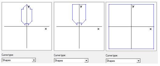

3. Define Ring shapes using SHP advanced profile (PCSLC-> SLC Tools->Profile Setup->Advanced Profiles->SHP) for Regular ring, rings at the top of the layout and Block Ring
4. Create Ring shapes (XY Curves) profiles (PCSLC à SLC ToolsàProfile Setup à Generate Ring Shapes)
5. Fill out the GEN advanced profile (PCSLC-> SLC Tools->Profile Setup->Advanced Profiles->GEN)

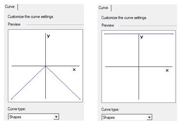

4. Create XY Curves for face shape (PCSLC-> SLC Tools->Profile Setup->XY Curves)
5. Fill out the TTL advanced profile (PCSLC-> SLC Tools->Profile Setup->Advanced Profiles->TTL)
