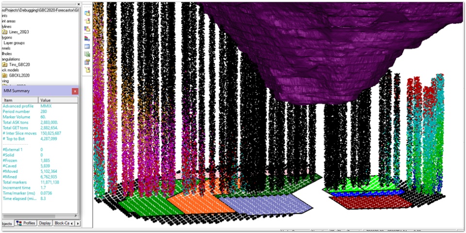

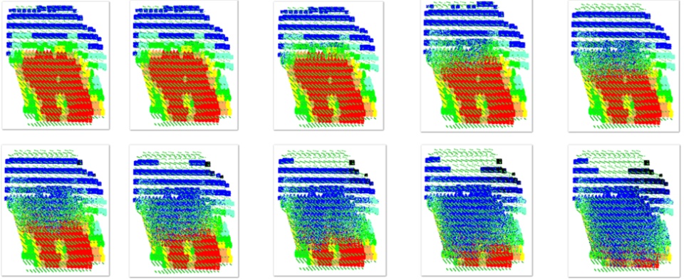

Display examples

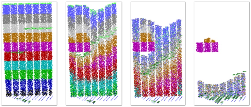

Cave back and toppling from top
GBC example (with External material)

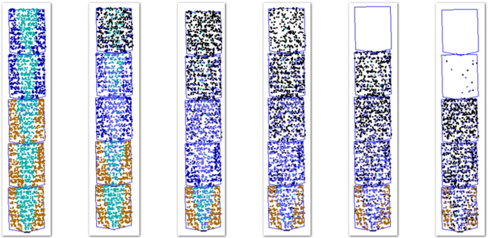

Frozen and erosion example โ 5 rings
