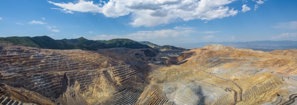

At the moment it seems very little has changed.
If a miner who was there when the first sod was turned at what is now Rio Tinto's Bingham Canyon copper mine in Utah, US more than 100 years ago looked into the pit today he would know exactly what was going on.
While the equipment has become much larger - and it should be noted Bingham Canyon had train and shovel rather than truck and shovel mining up until the 1980s - the process has remained the same.
