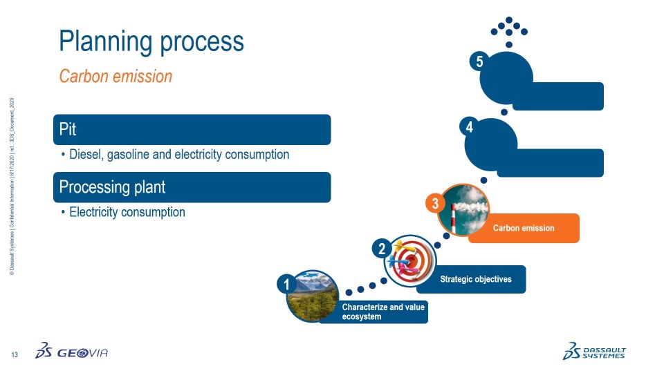

The approach of the solution is the incorporation of ecological costs (carbon emissions, area of damaged pits, waste dumps and tailings dam, value depreciation of direct and indirect ecological services) in order to optimize the plan with a new "Green NPV" that considers all these costs.
These ecological costs should not be ignored anymore, as they are present in every mining operation either as explicit or opportunity costs. Therefore, they must be considered in the decision-making analysis and included in a logical way in the strategic mine planning process.
