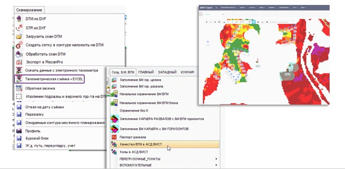

The survey is ready, the surveyor connects the device to the PC, opens GEOVIA Surpac, starts the function of importing and processing survey data, selects from the list what needs to be obtained as a result. The system generates graphical and tabular data, updates the working file on the network resource and saves the previous version of the file. The geologist launches the functions of updating the block model according to the current mine surveying data and / or data from the dispatching systems. All data is loaded from a network resource / platform, the macro command converts and imports the necessary data, the geologist only needs to select the appropriate settings. After checking the result, using the appropriate functions,

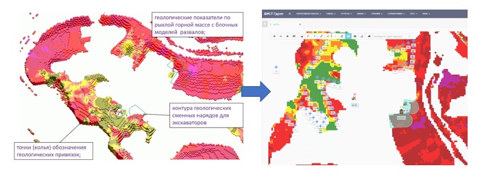

In 2019, the VIST Group automated dispatching system was introduced at the Kachkanar GOK. The implementation of this solution made it possible to increase production control of the operation of mining and transport equipment, the movement of ore from the faces to the transfer points, as well as to promptly receive data on the volume and quality indicators in the faces and at the transfer points. A two-way integration of the ASD VIST and GEOVIA Surpac systems was carried out, which made it possible to use the obtained data (position of the equipment, the degree of working of the face, the balance of rock mass at transfer points, the distribution of quality at transfer points, etc.) for operational planning and design of mining operations, as well as control the production process at the level of the line manager and the excavator driver.
3 - Implementation of GEOVIA Surpac
Thanks to the developments of the leading geologist S.M. Nekrasov and chief mine surveyor С.М. Некрасова, specialists of the mine surveying and geological departments using GEOVA Surpac tools automated most of the processes for processing mine survey data, design, creating printed documentation, creating geological block models, updating geological and mine surveying information on a network resource. Now specialists do not need to perform repetitive processes every day, whether it is uploading / downloading a survey from the device / to the device, searching for the necessary data for everyday work in a huge variety of folders. The GEOVIA Surpac macros do this for them. It is important to note that this data is available to all involved professionals across different departments. For example, to open the latest open pit survey, an updated block model,
Automation tools made it easy to integrate GEOVIA Surpac and ASD VIST Group and make this process as simple and fast as possible.

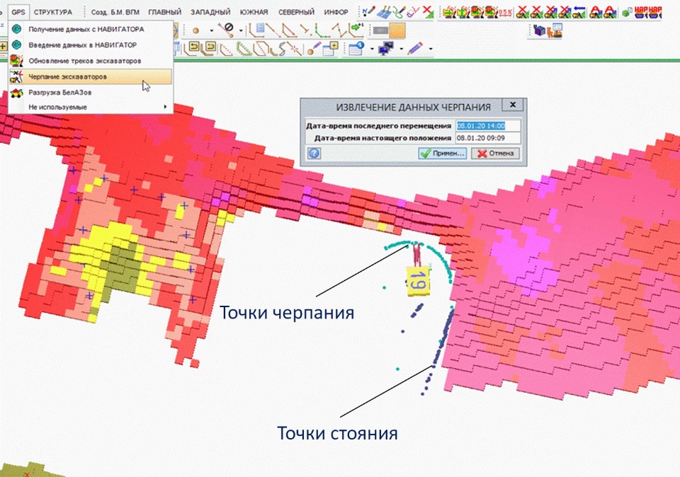

By selecting the appropriate menu in the GEOVIA Surpac panel, the geologist receives from the ASD VIST operational data on the development of the block or data for a specific date and time. This data is used to analyze the current situation and update the block model.
After updating the block model and ore / stripping contacts in GEOVIA Surpac, the geologist uploads this information to the ASD VIST system by pressing one button, after which the data is available to all users in both systems.

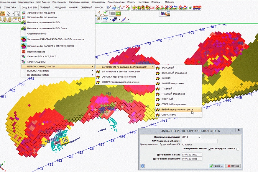

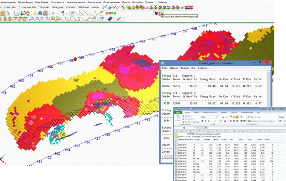

By combining the capabilities of the mining equipment positioning toolkit in the ASD VIST Group system and the GEOVIA Surpac tools, the processes of controlling the movement of rock mass from the face to the transfer point, placing the rock mass in the sectors of transfer points, monitoring the balance of the arrival / departure of the rock mass by sectors and maintaining mobile residues were set up. for the period of operational filling. For this, in GEOVIA Surpac, block models of transshipment points were created, and a methodology for filling them was developed. At the request of the geologist, the process of entering the rock mass into the block model (BM) to the virtual transshipment point, as well as the shipment from it, can be carried out both as a whole for the past period, and in an operational mode.
By placing the BM on filling with the end time, the macro program itself makes a request, after a certain period of time, to retrieve data on excavators carrying out scooping, and also retrieves information on the movement and unloading of vehicles at the transfer point. Thus, at the end of the macro program, current information is generated on the state of the warehouse, the presence of rock mass for a given period of time in a three-dimensional graphical form, and a summary table of the results of operational changes. This made it possible to quickly track the movement of ore, the balance and distribution of rock mass in the sectors of the transshipment points, as well as to present this information graphically in both systems and to have quick, free and secure access to information for all employees. In particular, according to the leading geologist S.N. Nekrasov, This process has improved the accuracy of planning shipment in terms of quality from transshipment points to rail transport. He also notes that if earlier they only assumed what was brought to the transshipment points and represented only the average quality value for the sectors, today the indicators are known for each individual sector of the sector.

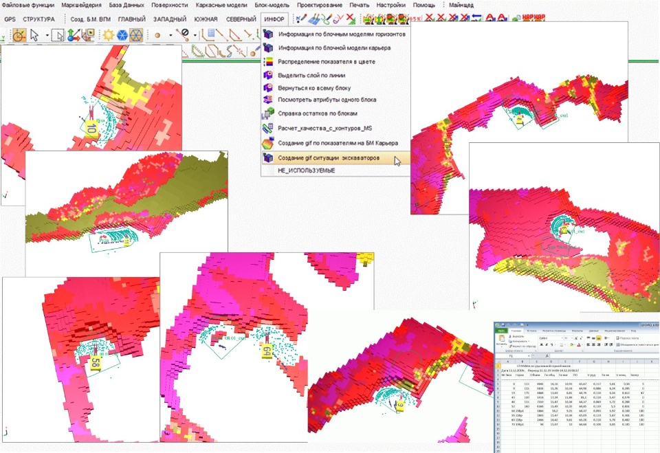

For a quick analysis of all sectors of transshipment points and the formation of a tabular report in GEOVIA Surpac, a macro command was written that displays and saves graphical information in the specified format. At the same time, there is no need to open the block model of each sector, apply constraints, color the block model by attributes, or manually generate tabular reporting. All this is done with the push of a button.
