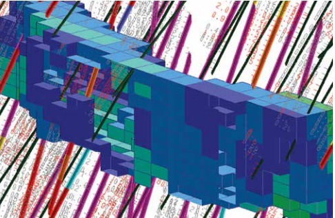

Surpac drillholes with block model orebody constraint
