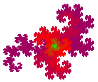

Dragon Curve

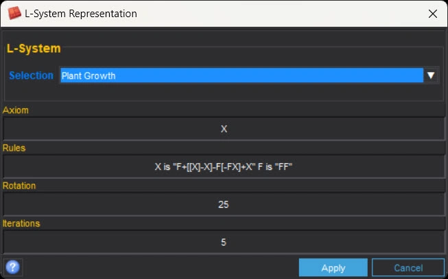

First of all, the form.  There are 14 different L-Systems to choose from.  Each L-System requires an "Axiom" some "Rules" a "Rotation angle" and the number of "Iterations".
  • The Axiom is the starting condition, "X" in the above form.
  • The Rules tell the drawing program how to move.  i.e. The rule for X is "F+[[X]-X]-F[-FX]+X" (More on this in a bit)
  • The Rotation is the angle to turn either left (-) or right (+) in this case 25 degrees
  • The Iterations controls how many times we will repeat the rules.
To expand this further, when the program sees the axiom "X" it generates the sentence, "F+[[X]-X]-F[-FX]+X".  When the program sees "F" it generates the sentence "FF".
So the program starts by reading the Axiom "X" and generating sentence "F+[[X]-X]-F[-FX]+X".  The second iteration will read the sentence generated in the first iteration so the sentence becomes "FF+[[F+[[X]-X]-F[-FX]+X]-F+[[X]-X]-F[-FX]+X]-FF[-FFF+[[X]-X]-F[-FX]+X]+F+[[X]-X]-F[-FX]+X"
I hope you can see how quickly the sentence can grow from some basic rules.  This sentence is then given to the "Turtle" drawing program which executes the sentence commands. i.e. F = Move forward, + = Turn right 25 degrees, - = Turn left 25 degrees, [ = store current position, ] = Return to previous position.

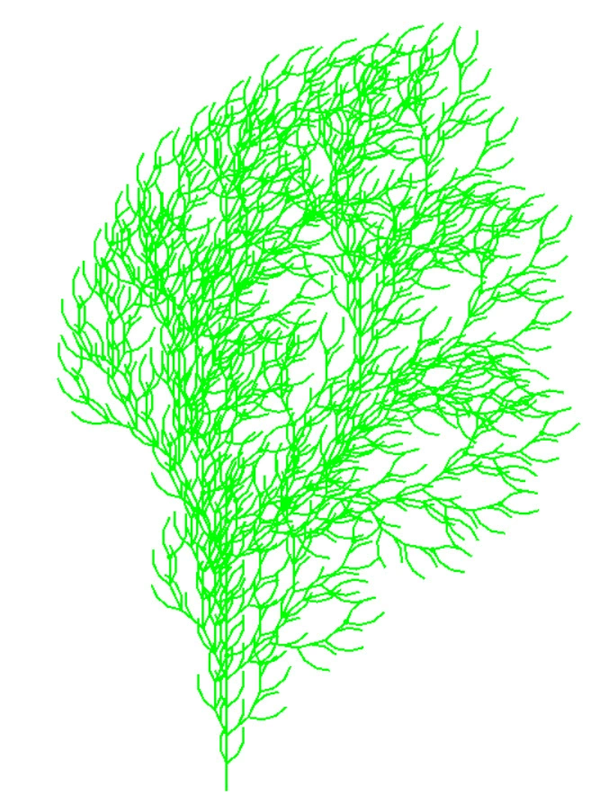

Barnsley Fern

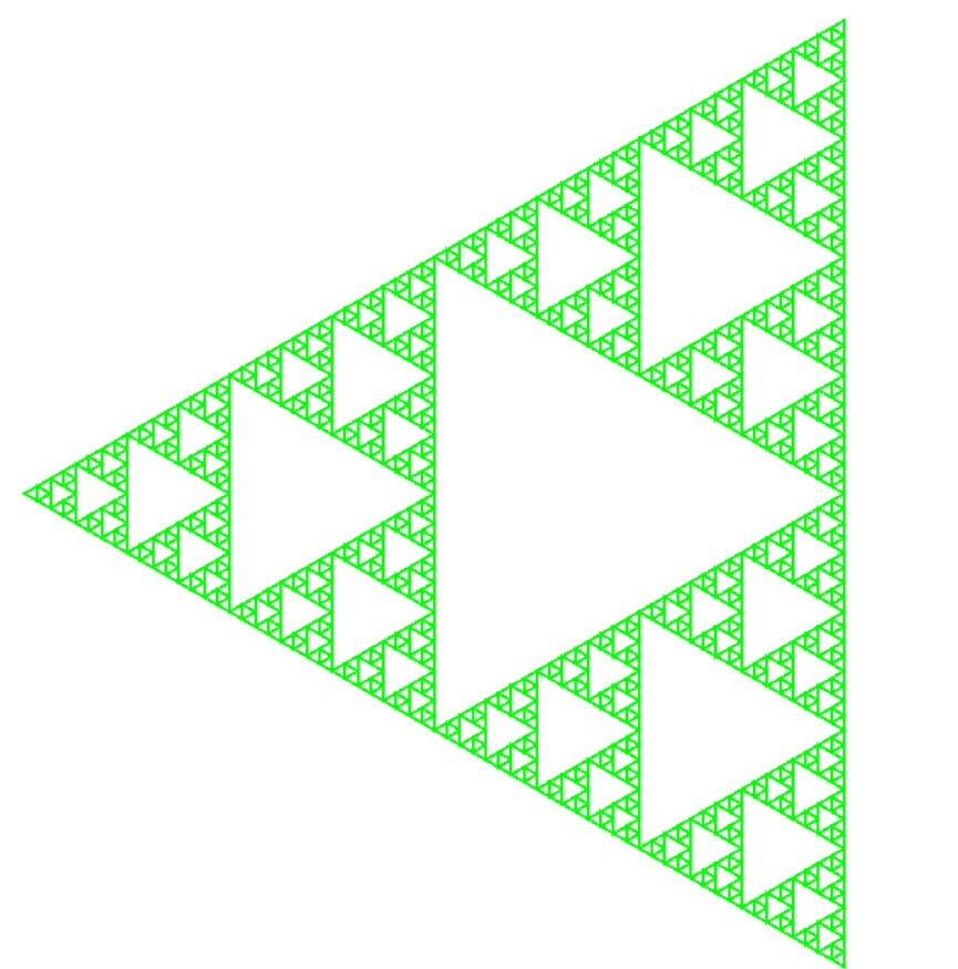

Sierpinski Triangle

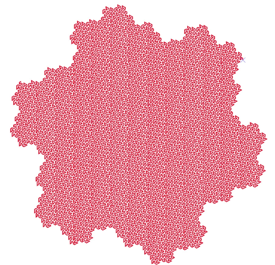

Gosper Curve

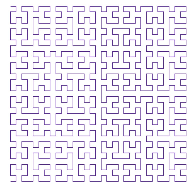

Hilbert Curve
