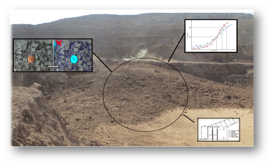

Drill-and-Blast: First step in the comminution process
Rock fragmentation is considered one of the most important aspects of production blasting because it impacts both the costs of drilling and blasting and the efficiency of subsystems, such as loading, hauling, crushing and milling.
Rock fragmentation is influenced by parameters, which can be categorized as:
  • controllable (e.g. drillhole geometry, sequence and explosive properties), and
  • uncontrollable (rock mass properties).
The mismatch between blast design parameters and rock mass properties causes energy dissipation in rock blasting.  When the explosive energy releases, apart from useful rock fragmentation and displacement, a considerable portion of that explosive energy is wasted in the form of undesirable side effects, such as ground vibration, noise, flyrock, over-breaks, ore loss, and dilution.  However, a well-designed blast can result in “good” fragmentation and fewer side effects.
Typically, blasting is considered “good” when drill-and-blast costs are minimal and it fragments rock into particles that are fine enough and loose enough to be easily loaded and hauled away to the process plant.  With the mine-to-mill approach, on the other hand, the degree of blast fragmentation is driven by feed-size requirements defined by the process plant.  While producing the finer fragmentation commonly results in higher drill-and-blast costs, however, this increase can be justified in light of that fact that ore comminution is the most energy-intensive process in almost all mines. Therefore, a quality ore feed specifically tailored in size and metal content to meet milling requirements not only improves process performance in short-term, but also assists with significantly increased overall value over life-of-mine.
The crushing and grinding process is more or less efficient depending on the ROM size distribution, particularly for autogenous (AG) and semi-autogenous (SAG) milling, because a significant proportion of the grinding media (in AG mills, all of it) is comprised of ore feed.  The more closely ore feed size distributions match downstream requirements, the more efficient, and therefore more profitable the processing will be.
