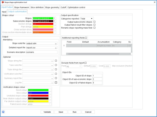

GEOVIA Stope optimiser requires a block model containing either grade, value or density attributes, along with an optional but recommended stope control surface. The control surface is used to guide the orientation and shape of the stopes, default dip and strike can be used if surface or model controls are absent. It also has the option to include inclusion or exclusion zones, sub-shapes, over break controls, post-processing (smooth, split & merge options), variable cut-offs and head grade.

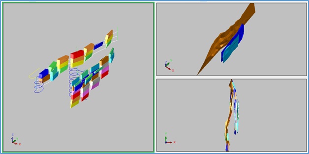

Optimised underground stopes in Surpac using trend surfaces
GEOVIA STOPE OPTIMIZER automatically generates the highest value stope solids that maximise recovered resource above cut-off grade or value, across a wide range of mining method geometries and orebody types. Splitting, smoothing and merging options are available to fine-tune desired stope shapes. GEOVIA STOPE OPTIMIZER allows defining numerous properties for the stopes including practical mining parameters such as minimum and maximum mining width, anticipated wall dilution, Pillar sizes, cut-off grade, cost and revenue, mining limits, minimum wall angles and many other factors.

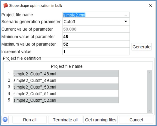

STOPE SHAPE OPTIMIZATION IN BULK or SSOB function can be utilised to create multiple stope shape optimizer XML project files and run them simultaneously in the latest version.
The function can be accessed from the following menus
  • Design > Stope shape optimizer > Stope shape optimization in bulk
  • Block model > Block model > Stope shape optimization in bulk
  • Type SSOB in the command window
Example of stope shape optimizer in bulk

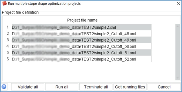

Latest Surpac can run multiple stope shape optimizer XML project files simultaneously using STOPE OPTIMIZER MULTIPLE or SSOM function.
  • Design > Stope shape optimizer > Stope shape optimizer multiple
  • Block model > Block model > Stope shape optimizer multiple
  • Type SSOM in the command window
Example of multiple stope shape optimization projects

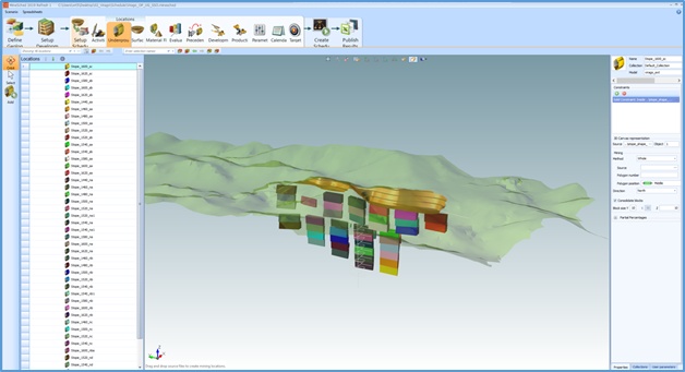

GEOVIA STOPE OPTIMIZER is fully integrated within user-friendly GEOVIA SURPAC™ and the stopes generated can be directly imported into GEOVIA MineSched™ for underground scheduling. This provides a total end to end solution for long term strategic underground scheduling.
Optimised stopes imported into MineSched for production scheduling
