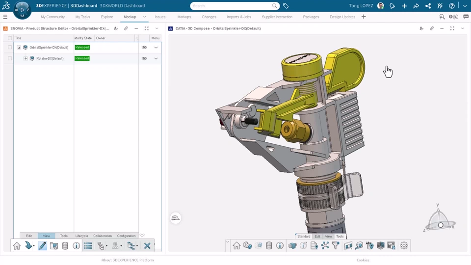

Let’s take a look at an example of volume search in action using 3D Compose.
