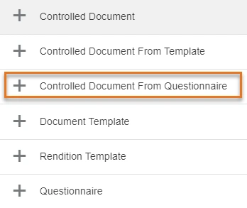

When is the Questionnaire used?When creating a new Controlled Document From Questionnaire

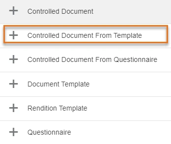

When creating a new Controlled Document From Template

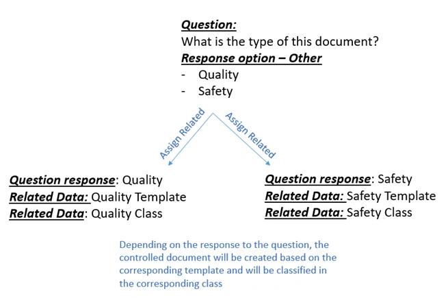

Examples:
The following examples illustrate the creation and the usage of Creation Questionnaire in more detail:
Example #1
Depending on the response to the question, the controlled document will be created based on the corresponding template and will be classified in the appropriate class.
