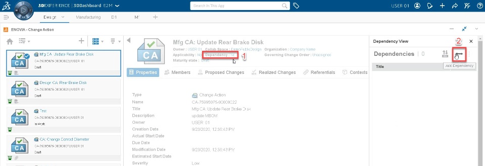

  1. In Manufacturing CA, click “Dependency,” value “No” -> the “Dependency View” appears
  2. Click “Add Dependency” -> 3D Search opens

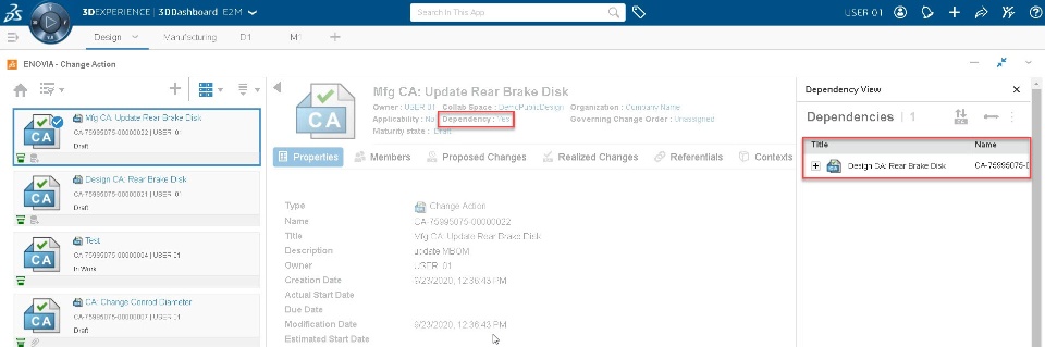

  3. Search and select the Design CA -> the Design CA appears in “Dependency View”
