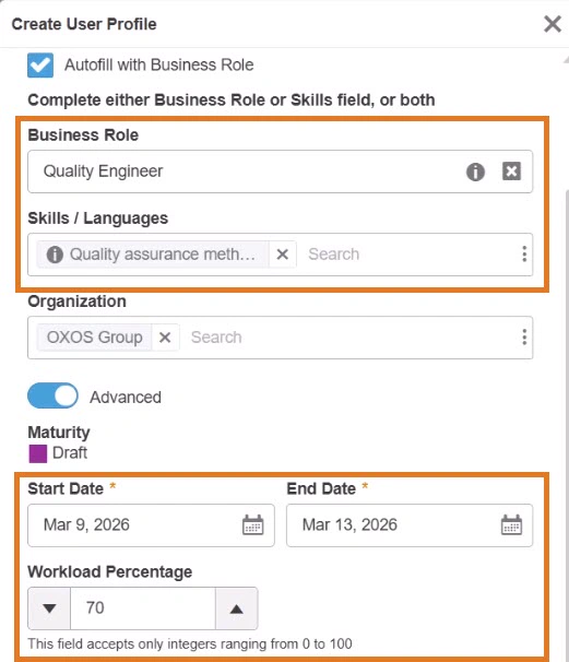

  1. Create workforce requests (User Profiles), which indicate the resource needs for the project.
Note: to create a user profile you need to have both 'Project Planner' (XPP-OC) and 'Workforce Manager' (WXO-OC) roles assigned to you.
  1. The User Profile is used to capture the request for the resource and include:
    1. Required capabilities (Skills and Business Roles)
    2. Required capacity (Duration and the Workload Percentage)

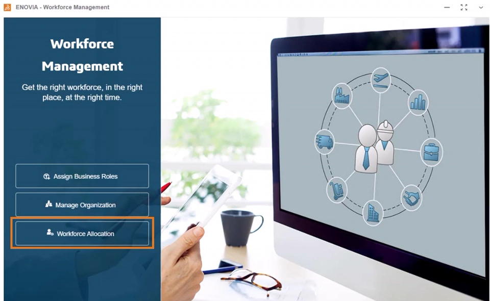

Application – Workforce Management web app (Workforce Manager XWO-OC role)

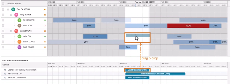

  1. Open the 'Workforce Allocation' page to work on workforce requests.
  1. Access all 'In Work' requests grouped by projects, either from:
    1. 'My Requests & Approvals' side panel
    2. 'Workforce Allocation Needs' section
  1. Select the request and use 'Show Suggestion' to get color indication how suitable the users are.
The color indication is based on:
a. Availability
b. Business Roles
c. Skills
Color
Indication:
Example:
The user matches workforce request requirements
The user partially matches workforce request requirements
The user does not match workforce request requirements
  1. Assign the request to selected candidate by dragging and dropping the request from the 'Workforce Allocation Needs' panel to the ' Workforce Users' panel to the respective candidate row.

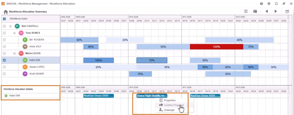

  1. Confirm the proposal to promote the request to 'Proposed' maturity state and initiate the approval stage.

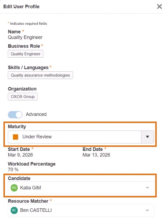

  1. View the suggested Candidate and approve it by promoting the User Profile (workforce request) to 'Under Review'
3.2 Approve / Reject suggestion by Request Approver (direct manager of the Candidate)
Persona – Approver (the candidate's Direct Manager)
Approve or reject the request either from:
  2. 'Workforce Allocation Details' section
