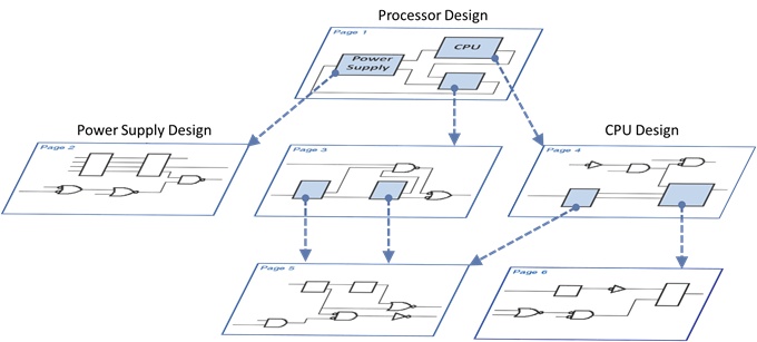

Hierarchical schematic design, sometimes referred to as modular or block design, is where different schematic designs are represented by block symbols on the top sheet of the main design. Larger designs may also have more than just one top sheet with block symbols. In some cases, a block symbol on the top sheet will represent another sheet with additional blocks symbols on it.
Each block symbol on the top sheet represents its own schematic design. A processor design with a power supply and CPU is a good example. The power supply and CPU can have their own block symbols on the top sheet of the processor design. See the example in Figure 1 below.
Figure 1: Processor design using block symbols
