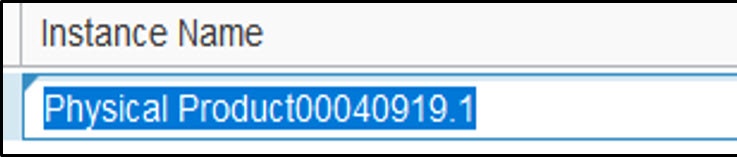

  • Title
  • Instance name
  • Description
By double clicking on the attribute content
Content can be edited directly within the attribute

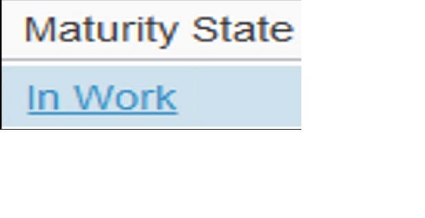

  • Revision
  • Maturity State
  • Part Number
  • Responsible
By a single clicking on the attribute content
(The content is a hyper-linked)
The respective pop-up is launched for content update:

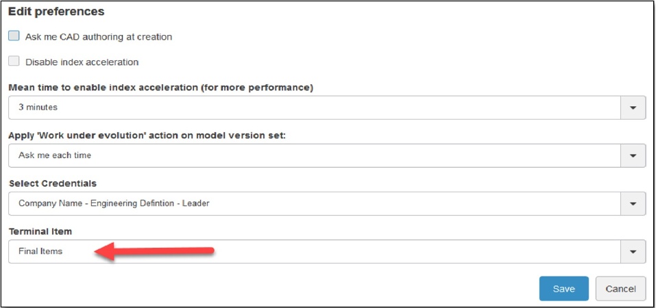

The preferences of “Release Engineer” widget
The “Terminal node” engineering items have a “True” value of their customized attribute (“Final Items” in this example)

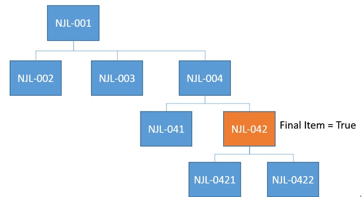

Here is an example:

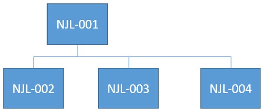

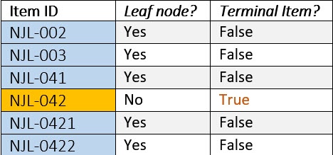

This engineering definition contains the following items:
The value of the customized attribute is “False” for all items, except of Item NJL-042 where it is “True”.

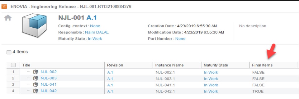

Once the widget preference is updated with the “customized attribute” (“Terminal Item” value = the customized attribute name):

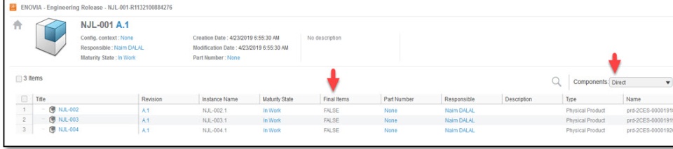

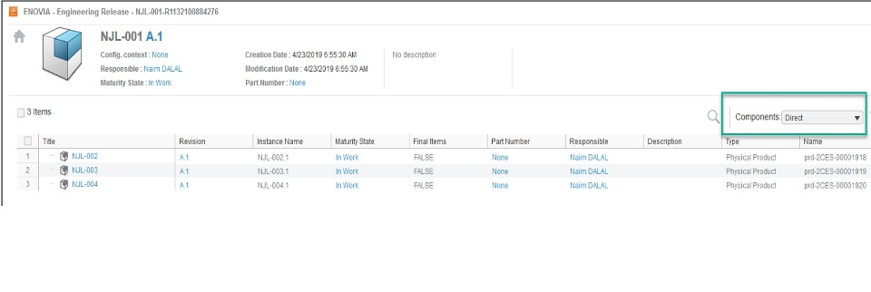

  • if we open the root item NJL-001 in the widget, then select the option “Direct” (in the “Components”), then we will get the following structure (the root node in the widget is “NJL-001”):
The reason is:
Only the direct children of NJL-001 are displayed

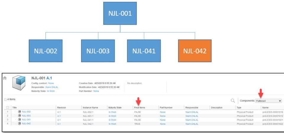

  • If we select the option “Flattened” in the same root item NJL-001, then it will display any direct child item that does not itself have children (“Leaf Items”), or any other item that has been identified as a “Terminal Item”.
The reason is:
  • NJL-002 and NJL-003 are direct children of NJL-001, and do not have any children. Thus, they are displayed.
  • The direct child of NJL-004 has children of its own and, therefore, is not shown. Instead, its final children will be elevated to the “Flattened” view – so NJL-041 is shown.
  • NJL-042 is also displayed, even though it has its own children, because it has been identified as a Terminal Item
