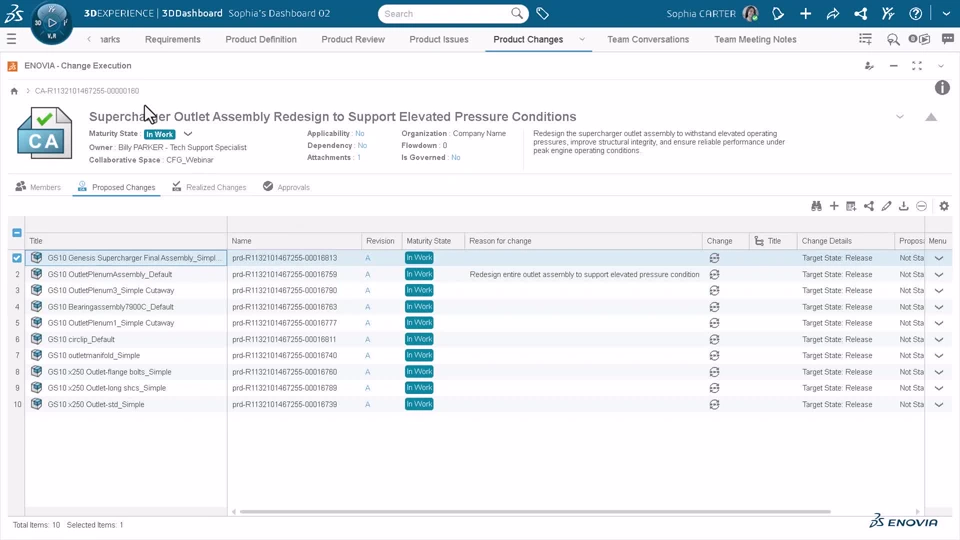

1) Accurately Propagating Changes from Engineering to Manufacturing
Many organizations struggle to accurately propagate engineering change information across downstream departments such as manufacturing, procurement and quality. Any inconsistency in this propagation can cause teams to work with outdated or inaccurate data, resulting in rework, production delays and costly shop-floor errors.
Using the Flowdown Dependency between change actions capability, you can ensure that:
  • Upstream changes are completely and accurately propagated across downstream functions. These changes are automatically populated in the Flowdown tab of the downstream change action.
  • Each Upstream change listed in the Flowdown tab is thoroughly analyzed before the downstream change action can be completed.
For example:
Refer to following demo video which explains this process:

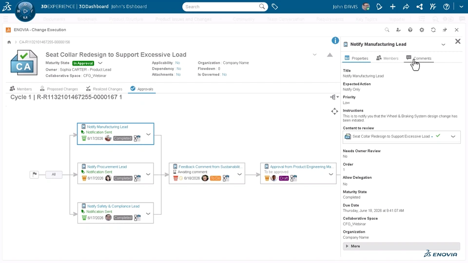

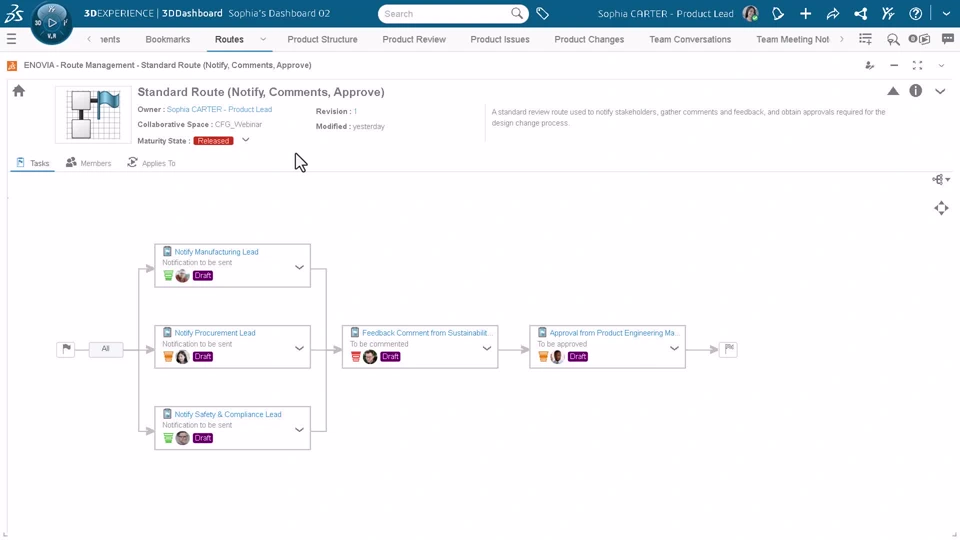

2) Using Standard Route for Change Action Approval
Most product leaders orchestrating the change process are familiar with the usage of the “Approval Route” template to manage approvals for Change Requests, Change Orders and Change Actions. However, this type of route is limited to “Approval” tasks only.
Using the “Standard Route” template provides greater flexibility. This template allows tasks with different objectives (Notify, Comment and Approve) to be arranged in any sequence, as long as at least one “Approve” task is included.
Refer to following demo video which explains this:

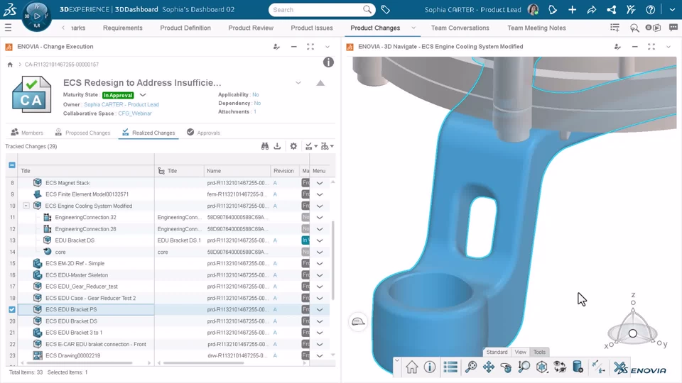

3)  Cross-highlight Objects in the Change Action
Reviewing or executing a Change Action requires users to quickly identify the exact part being reviewed or modified. In complex assemblies, this can be difficult without a clear visual link between the objects listed in the Change Action and their position in 3D.
ENOVIA Change Management addresses this topic with the cross-highlight capability, which creates a direct connection between objects in the Proposed Changes or Realized Changes list and the corresponding item in the 3D view.
This is especially useful in two scenarios:
  • Web Apps: For Approvers and Product Leads, selecting an object in the Realized Change section highlights it in the 3D viewer (3DPlay, 3D Navigator). You can also use the Focus which option reframes the geometry around it for easier inspection.
  • Desktop Apps: For CAD Engineers, cross-highlighting between the Proposed Changes list, product structure, and 3D model helps ensure they are modifying the correct object in the right change context.
