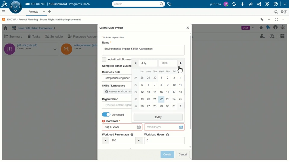

As a Project Leader, once you identify a workforce need, you can create a User Profile that serves both as a placeholder for a future team member and as a Workforce Request. This allows you to initiate the resource allocation process while continuing to plan your project in the meantime.
How?
  1. Open your project in Project Planning app, and navigate to the Members tab.
  2. Use the ‘Create user Profile’ command to create a new User Profile.
  3. Enter the User Profile name, select the required business role, and specify the skills the person should have.
  4. Define the required capacity, including the time period and workload percentage.
  5. Assign the request to a Resource Manager, who will review the request and identify the best candidate to meet the business need.
