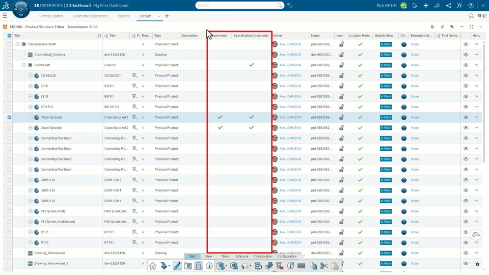

Useful Tip✅| Access Relations from the Product Tree
Did you know?
You can access the Relations to a product directly from a column in the Product Structure Editor or Product Explorer tree?
How?
Add the Specification and Attachments to the columns of the tree list view
Refresh the screen and you will see the new columns and can now expose the relationships from the info panel by clicking any of the checkmarks that appear in the columns.
