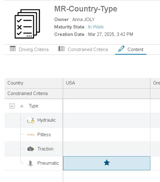

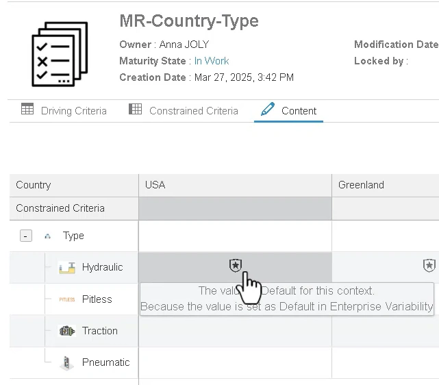

Overwriting Default Values
When creating the Enterprise Variability, you can set the default values for the variants. This default value definition remains consistent for all the Model Versions in which the selected variant is used.
However, for the few Model Versions, there can be an exceptional need to assign different default values. To cater for such needs, this enhancement is provided that lets you leverage the Matrix Rule to overwrite default value definition set in the Enterprise Variability.
While defining a Matrix Rule, an icon and message are displayed indicating the default value selected in Enterprise Variability.
You can select the different default value which overwrites such default values.
When you perform the Product Configuration, the default values set in the Matrix Rule are considered over the default values set in the Enterprise Variability.

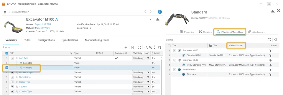

“Where Used” Assessment for Variability
In the configured product structure, product instances are mapped with the variability defined in the contextual Model Version. This is typically referred to as ‘effectivity definition’.
While modifying or removing any variant values in the model definition, it is important to assess its impact on the effectivity definition in the configured structure.
To quickly perform this assessment and enable informed decision making, you can now refer to the new “Effectivity Where Used” tab in the Information panel. This lists all the effectivities where selected variant value is used.
