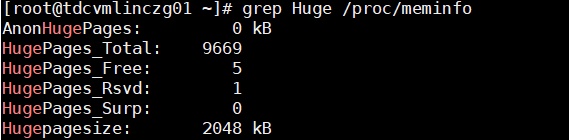

edit /etc/sysctl.conf add below line, the number is calculated by previous step, assume it is 77571
vm.nr_hugepages=77571
#sysctl -p  # to load setting from sysctl.conf
grep Huge /proc/meminfo   #to check if Hugepages is set
You will see HugePages_Total is the number you set, (sorry the picture is not same as my example)
and HugePages_Free will get smaller and smaller, it is being used by oracle.

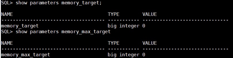

Step 4  At oracle disable AMM
two parameter should be 0
memory_target
memory_max_target
Enable ASMM
Set SGA_Target to a number which not exceed huge page size. 77571*2048=158865408​​​​​​​K
alter system set sga_target= 155136M;
alter system set sga_max_size= 155136M;
