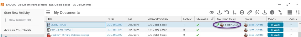

However, in case of Microsoft Office documents, the update can be done more seamlessly with the help of the Collaboration for Microsoft app. The action bar section in the Document Management widget has several commands which are widely used for performing various operations on documents. You can select the document and click on Edit. This automatically starts the download and opens the document in appropriate Microsoft Office application for you to start your update.
It is very important that the same document is locked for any concurrent modification by other users in the company. This is taken care of by the application, and you can see the name of the person who is currently editing the document in reservation status column. Until the document is unlocked or the update is complete, the document remains locked.

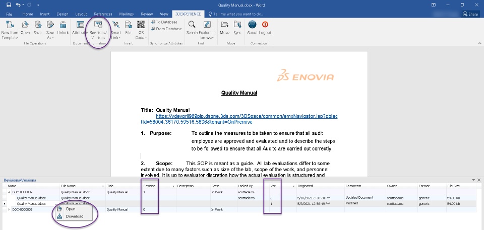

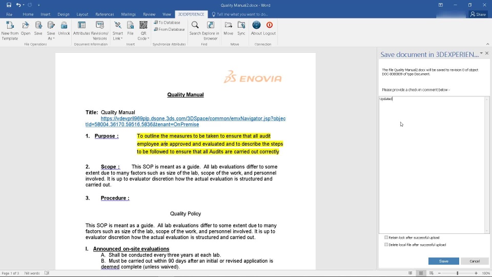

With the installation of the Collaboration for Microsoft comes the new 3DEXPERIENCE tab inside your Microsoft Office application. This tab gives you access to all the important commands that are useful to manage your document available in the 3DEXPERIENCE platform. Once your changes are complete, you can simply click on the Save command. This ensures that the updated file is saved in the 3DEXPERIENCE platform.

What if you don’t want to leave your active session of Microsoft Office? It is possible to search and open documents available in the 3DEXPERIENCE platform with the help of the Collaboration of Microsoft app. All you need to do is connect to the 3DEXPERIENCE platform and use Search command in the 3DEXPERIENCE tab.
For comparison or any other purpose, you can also find and download the old revisions and versions of the document.
