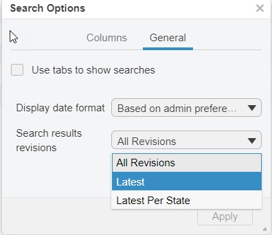

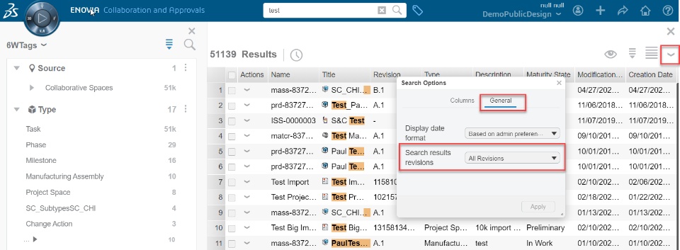

1. Local Setting Per User

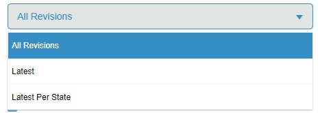

In the search results panel, a user can navigate to the Actions->Settings->General menu to configure “Search results revisions” to return “All Revisions,” “Latest” or “Latest Per State.”

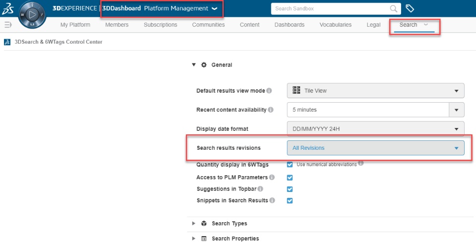

2. Global Setting for All Users
In the Search tab of the Platform Management dashboard, an administrator can configure “Search results revisions” to return “All Revisions,” “Latest” or “Latest Per State”. This is a global setting that applies to all searches, for all users.
