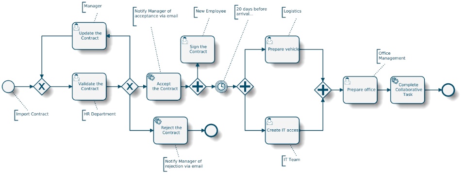

Example
Where (app): collaborative Task
Event that triggers a business process: Task maturity change
Meaning: when a task (such as “hiring”) is in maturity state “In Work” (meaning “started”), then a new process (such as “review employment contract”) begins

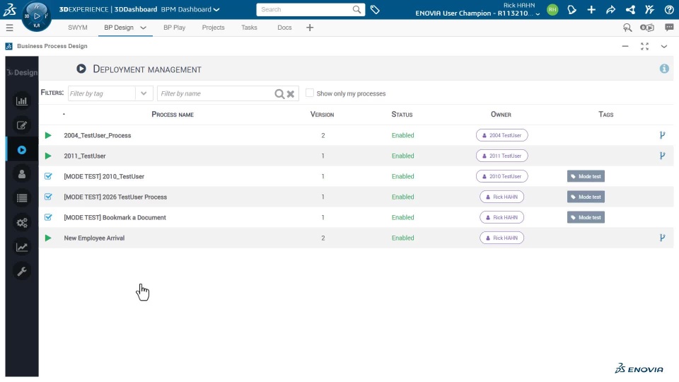

An example of such a business process:
Here is video that show an example of how we could start this process from a project plan:
