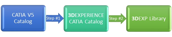

The migration path from CATIA V5 Catalog to 3DEXPEREINCE Library is composed of two main steps:
Step1: Migration from CATIA V5 Catalog to 3DEXPERIENCE CATIA Catalog by using the available migration tools, such as FBDI, DBDI and xPDM depending on the use case.
Step2: Migration from 3DEXPERIENCE CATIA Catalog to Classification Libraries by using the ‘Generate New Library Structure’ tool available from the native app.

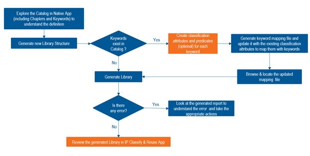

Generating Libraries from Catalog

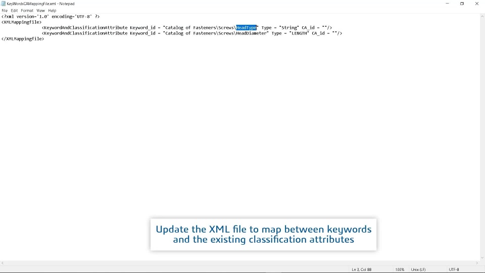

To generate a new library structure from a catalog, use the ‘Generate New Library Structure’ command from the native app. You will then get:
- A similar structure to that of the catalog
- All the classification attributes linked to respective classes
- The corresponding general classes and objects of the library are generated from the chapters and items of the catalog
The process to generate a new general library from a catalog is illustrated here:
