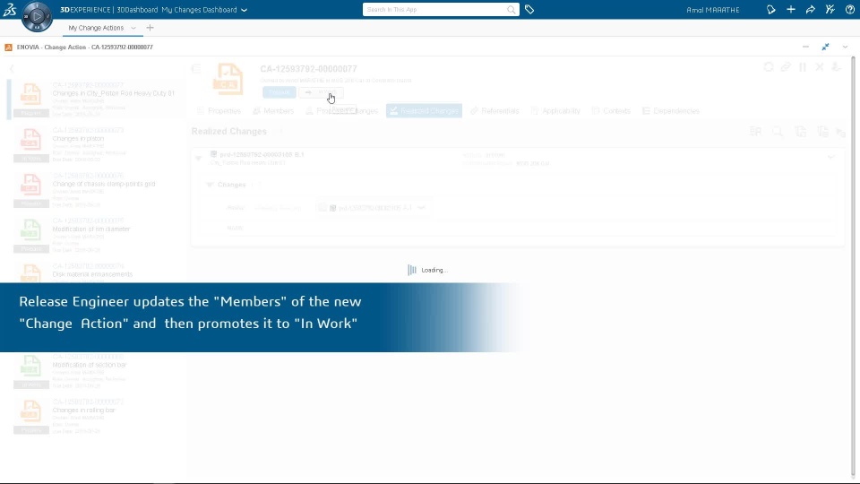

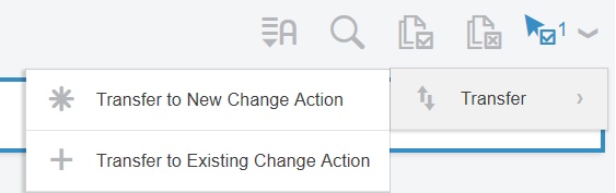

Users can move one or more “Realized Changes” to an existing or new Change Action.
Associated activities of these “Realized Changes” can also be transferred if required (that is optional).

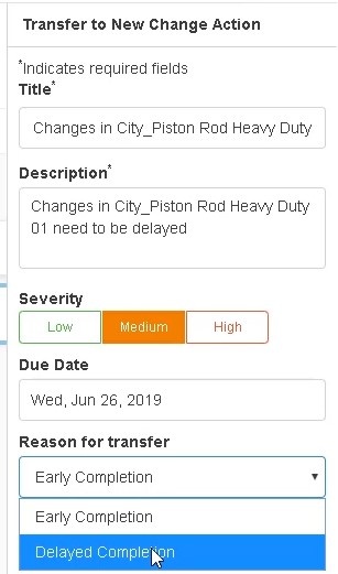

While transferring the “Realized Changes”, the user can select one of two reasons for such a transfer:
  • Early Completion
  • Delayed Completion

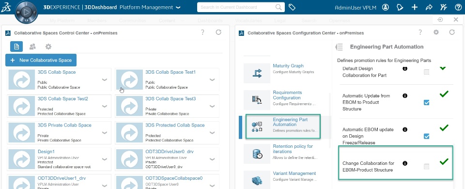

  • You must disable the ‘Change Collaboration for EBOM-Product Structure’ setting available in the “Collaborative Space Control Center” widget.
  • Use the “Multi-select” in the “Realized Changes” to enable the transfer of “Activities”.

For more information on this process, you can review the attached video (created by Amol MARATHE) which illustrates the transfer process.
