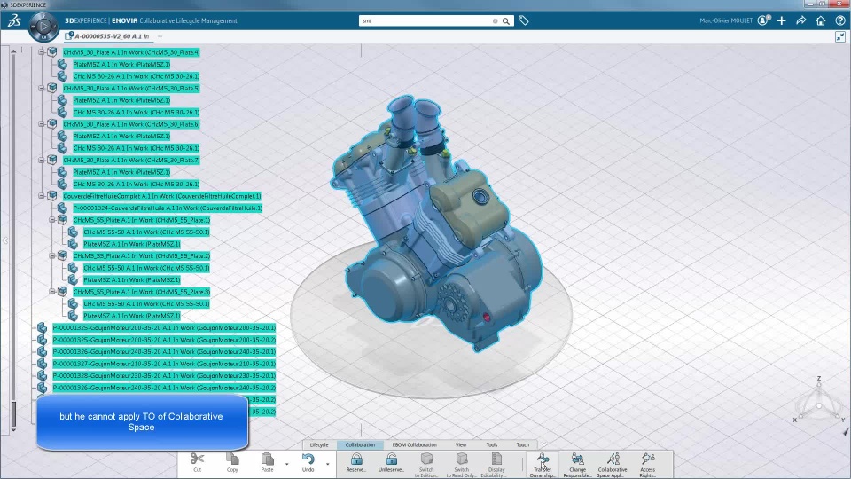

Since the beginning of our standard environment "3DSpace Baseline Behavior," the Transfer of Ownership of Collaborative Spaces required a connection with the Administrator role (VPLMAdmin). An automotive customer requested the ability to select the dedicated role for being able to apply the TO. This is now possible with the R2018x release. You can see the result in the attached video.
Technical tip: users must have authoring rights on the data they want to transfer. For example, a contributor will never have the allowance to transfer a physical product, only a review, even if the option for transfer is set to "Reader".
