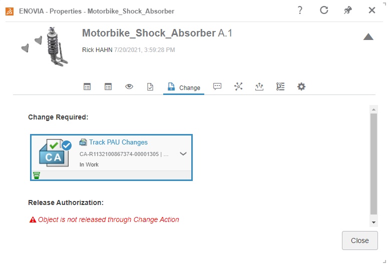

You can also review the current Change Action that is applied on the Engineering Item directly from the tab “Change” in the property panel:

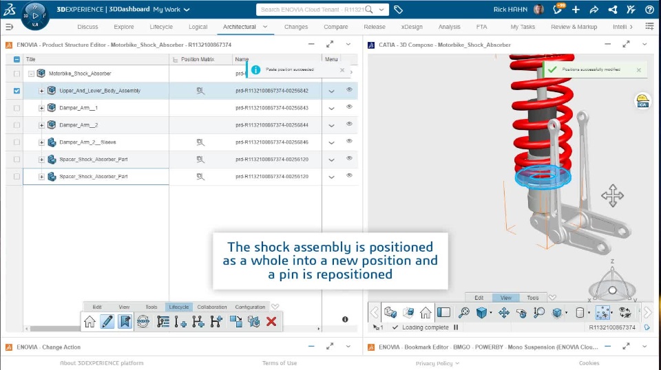

In the video below, we see an evolving design where the architect is making numerous and varied changes under the Work Under capability of a Change Action.
​​​​​​​Some further comments about the video...
