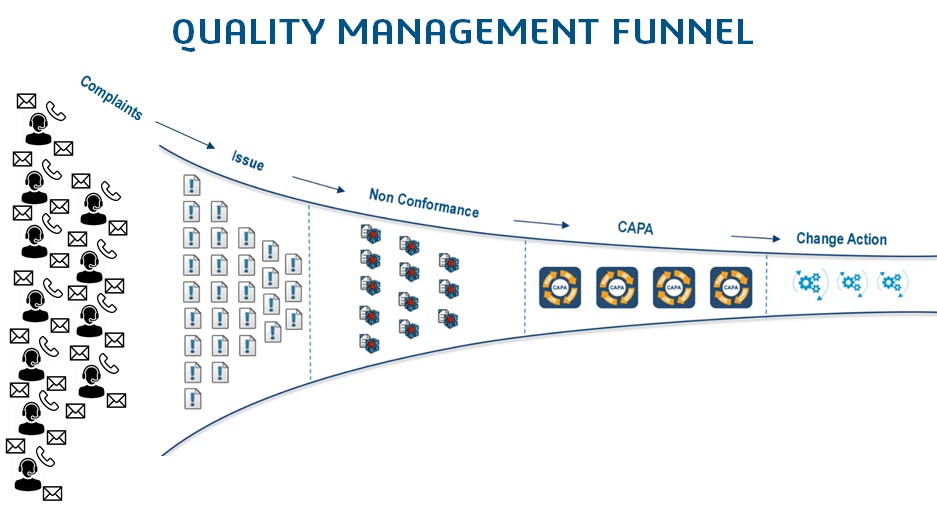

- A typical business receives a number of Complaints from their customers.
- The service agents solve many of these while on the phone, but a fraction of them turns into Issues that need additional work.
- Again, the team solves some issues at this stage, but others raise quality issues on the product or service. Hence, a smaller number of issues become Non-Conformance Reports (NCR) intended to address design or manufacturing problems.
- During the evaluation process, some NCRs have unknown root causes, so they turn into Corrective and Preventive Actions (CAPA) projects for further investigation.
- To prevent recurrence, the organization implements Change Actions as result from the quality activities described above.
This sequence of events, diminishing from many to few, is what we call the Quality Management Funnel.

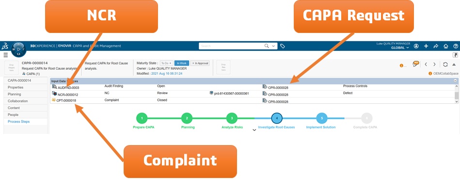

The ENOVIA Quality Manager role allows the creation of the different entities in the Quality Management Funnel above. In each instance, you can build traceability by creating a reference to the previous item. In the example below, this CAPA shows related Complaints, NCRs and CAPA Requests in the Input Data Sources section.

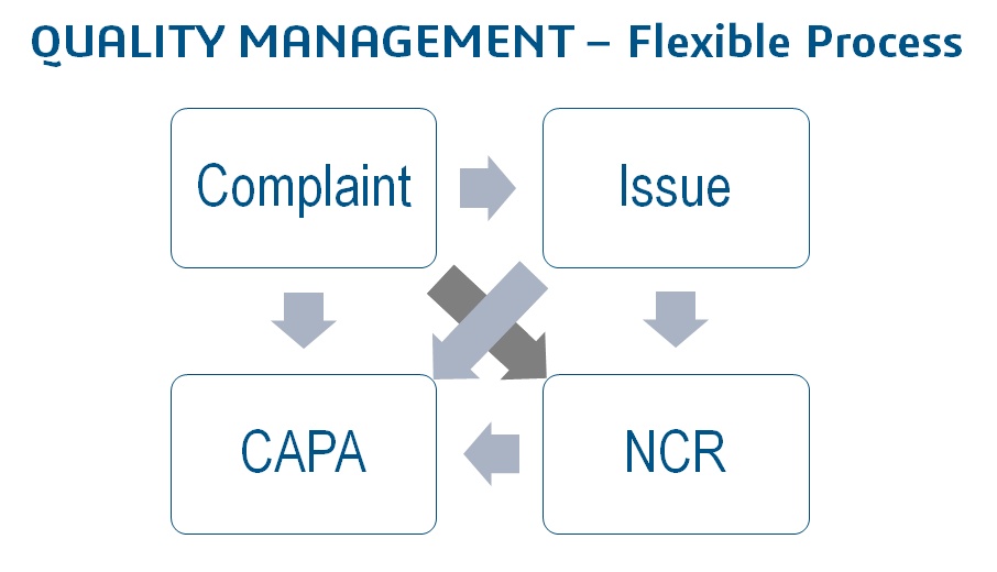

While the funnel appears to show a fixed sequence of items, in reality ENOVIA Quality Management allows the creation of items in a flexible manner. As the following image describes, a CAPA can be created after any of the other quality activities; and the quality funnel can start from any activity, not necessarily from Complaints.
