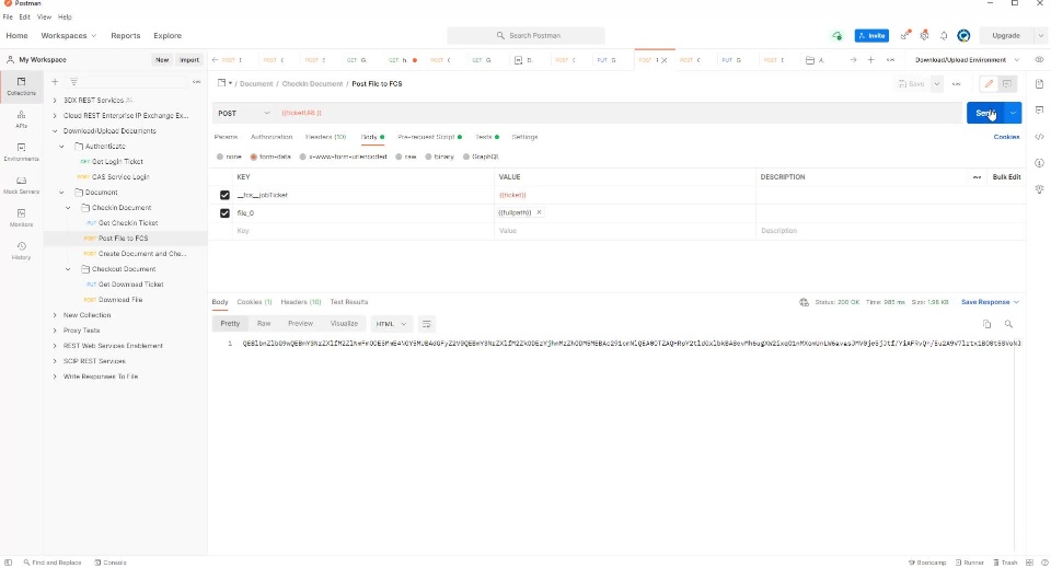

Upload File (Create Document)
  • Get Checkin Ticket from FCS
    • Retrieve ticket, ticketURL, and ENO_CSRF_TOKEN header value
  • Post File to FCS using ticket
    • Post file to ticketURL using ticket and full path to filename as form-data
  • Create Document and Checkin File
    • Create document object referencing FCS receipt received previously when posting to FCS
