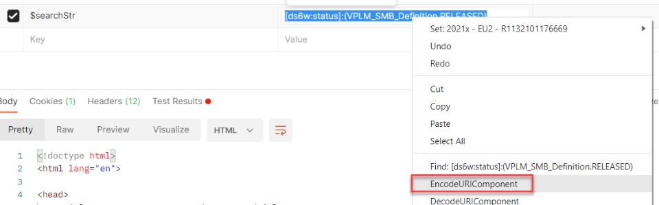

NOTE: In the samples provided below, because \\\$searchStr is a URL parameter it must be URI encoded. Tools like Postman can do this for you pretty easily and most programming languages have a helper function to accomplish this as well.
Postman URI Encode String: Select string to encode, Right click, select EncodeURIComponent
