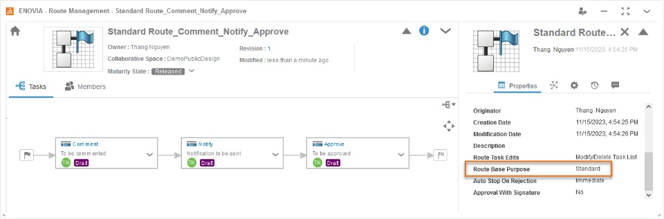

Standard Route Template definition:

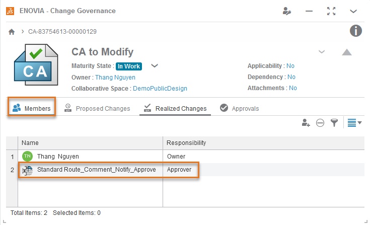

Standard Route Template added as Approver for Change Action:

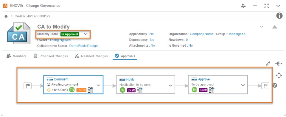

"Comment", "Notify", and "Approve" tasks are created for Change Action approval:
