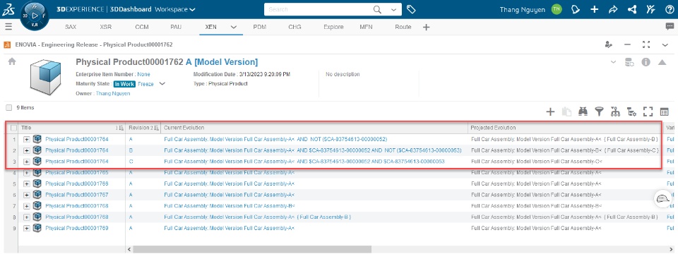

In the image below, you can see that I'm replacing "Physical Product00001764" revision A with B using Change Action named "CA-83754613-00000052" and concurrently replacing revision B with C using Change Action named "CA-83754613-00000053".  The goal is to have:
  • "Physical Product00001764 revision A" available for "Model Version revision A" evolution as shown in row 1's "Projected Evolution" column.
  • "Physical Product00001764 revision B" available for "Model Version revision B" evolution as shown in row 2's "Projected Evolution" column.
  • "Physical Product00001764 revision C" available for "Model Version revision C to infinity" evolution as shown in row 3's "Projected Evolution" column.
You cannot achieve the above stacking changes without using dependencies.  Please refer to the following link for similar guidance:  https://r1132100503382-eu1-3dswym.3dexperience.3ds.com/#community:38/post:udykfVZqQ2iSiZxrn4vR_w
Using "dependencies", we can achieve the Stack Changes function as shown in the very first image above.  You can validate the two Change Actions below against the "Current Evolution" column of very first image above:

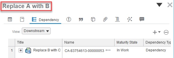

  • Change Action titled "Replace A with B" (with Name "CA-83754613-00000052") has a downstream Change Action titled "Replace B with C" (with Name "CA-83754613-00000053").

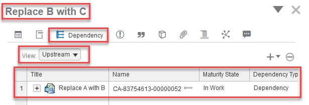

  • Or you can read it the other way that Change Action titled "Replace B with C" (with Name "CA-83754613-00000053") has an upstream Change Action titled "Replace A with B" (with Name "CA-83754613-00000052").
