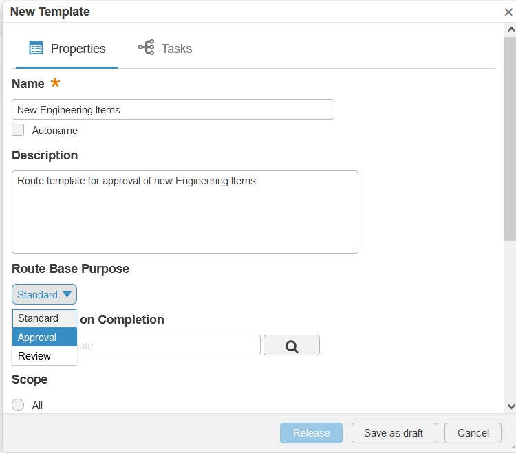

Route template
In order to enable the usage of a route in the approval process of the Change Action, route templates should be created and released. The “Route Base Purpose” attribute of the route template should be of type “Approval”:

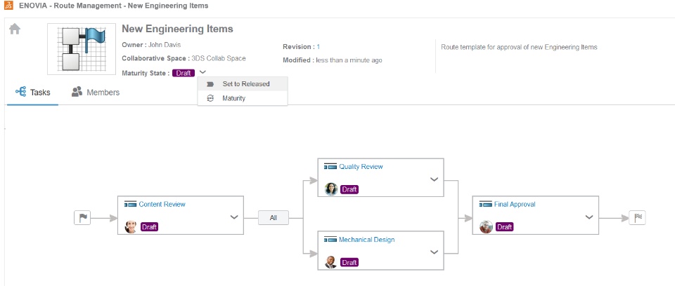

To release the route template, use the “Set to Released” option:

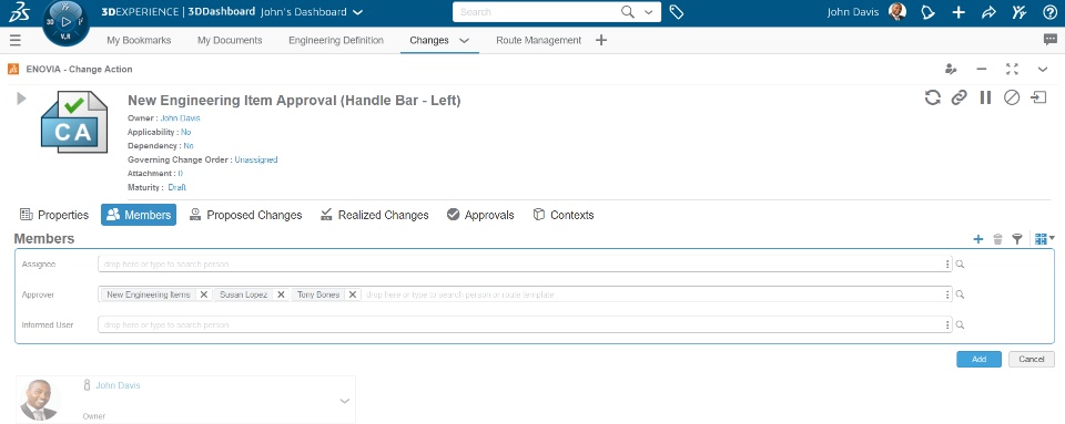

To add a route in the list of approvers in the Change Action, open the “Members” list and add the new route template into the list of “Approver”:
Note that you can add additional “direct” members as approvers.

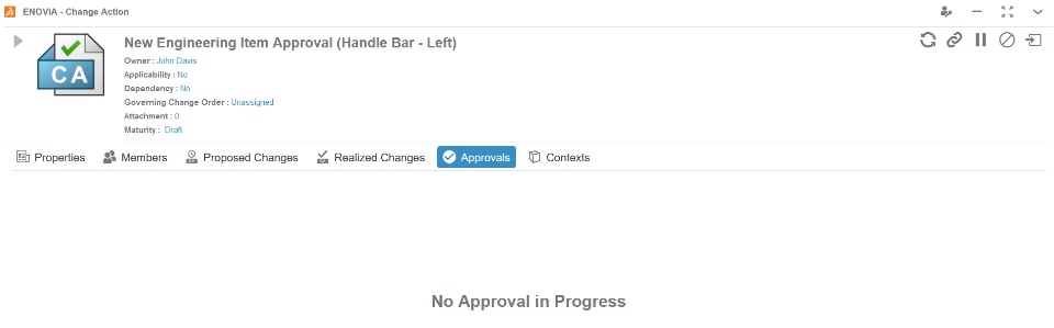

Change Action – Approvals:
As long as the Change Action is not yet in the state of “In Approval”, the list of “Approvals” will be empty, to indicate that the approval process has not yet started:

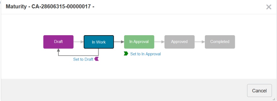

Setting the Maturity state of the Change Action to “In Approval” will initiate the process:
